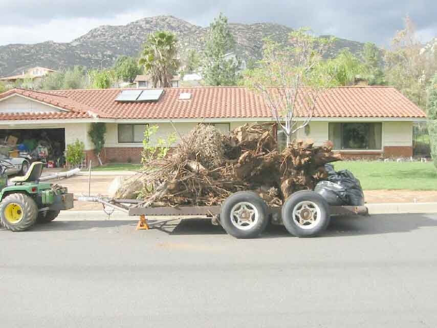

Postby deepmud » Fri Feb 19, 2010 11:53 pm
Said to be 6000 pounds of trailer and load.
I found that here:
http://www.tractorbynet.com/forums/buil ... ers-2.html
The jist of it is he ran his trailer for years as a single axle (like mine) then liked it so much he added a second axle and it had been used for 34 years when the thread was up in 2006. He mentions making others, including a 3axle race-truck hauler, and welding spindles to on from what ever the tow rig was made of to end up with matching wheel pattern and hubs - and using type 3 VW axles to be able to split them and get the track width he wanted AND even flipping them to make "lowrider" versions.
Great ideas.
EDIT: birddog, you should post the pic and link to your original thread.
