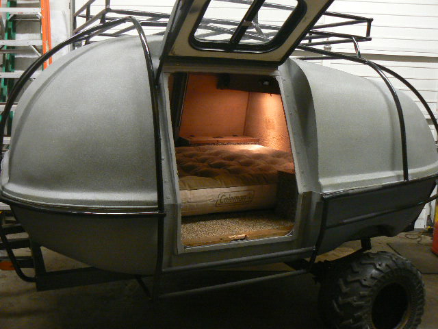

Postby boxcar » Wed Apr 21, 2010 9:31 am
Hre we have an almost finished version of the teardrop american I converted to an off roader To be towed behind my jeeps.ImageImage
