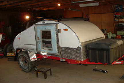

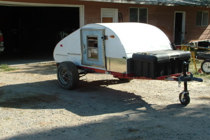

Postby High Desert » Sun Feb 14, 2010 12:09 am
hey I think thats great. One tough looking tear you've built there too. Did you upgrade the springs also or are they the stock HF ones?
And you're pulling it through some of the most magnificent country in the world 8)

Postby High Desert » Sun Feb 14, 2010 2:42 am
thanks for the details. Sounds like it works well. Did you make any mods to the tounge assembly or is it still stock other than the bulldog hitch? (which I think is a great addition)

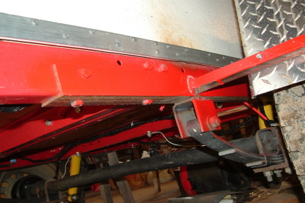

Postby urban5 » Wed Feb 17, 2010 12:05 am
I would love to know where you added the angle iron, I don't see it in your pics but it sounds like a good mod.

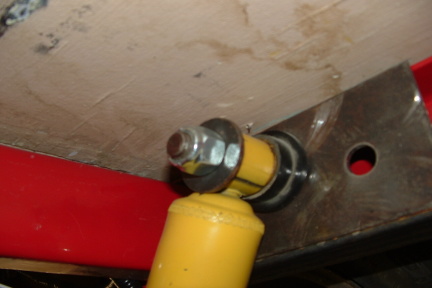

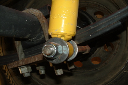

Postby Moosemt » Wed Feb 17, 2010 12:46 am
Can you post some pictures of your offroad shock suspension for me to look at. thanks.

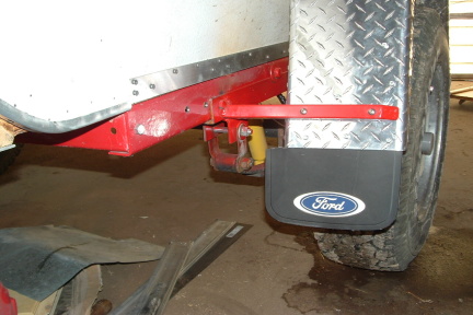

Postby deepmud » Sat May 22, 2010 3:46 pm
I see you added it at the spring hangers - I sort of expected it up at the tongue as well.
My folding trailer had a single tongue, not an A-Frame design like yours. It looks better than what I had, certainly.
Is that tongue stock or did you make it? The stickers I see make it seem stock - that is the most vulnerable to cracking, I think, so it's a good place to have a little more steel.
Your springs look brand new there - would you say they are softer riding than the stock springs on the HF?
I also agree shocks are GREAT idea on a trailer - but I think unless you run a soft spring (especially on initial compression, the first couple inches) then they don't help as much as they could.
