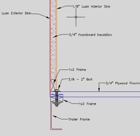

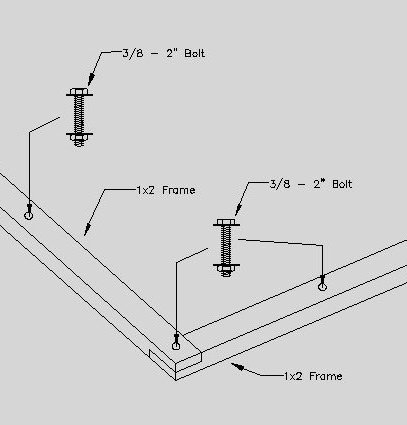

Here is what i have planned for the Flooring/Framing.
http://tnttt.com/album_ ... er_id=2667

Postby Geron » Tue Apr 03, 2007 3:51 am
BrianW wrote:Thanks for the welcome's. I am in Alabaster, just south of Birmingham
Brian,
Are you allowing for any insulation in the floor. If you are, I don't see it.

Postby toypusher » Tue Apr 03, 2007 5:28 am
Brian,
That looks good to me, but I think that you could use 1/2" plywood for the floor and cut a rabbit in your 1x2 framing to set it into. Unless you have very little or no support underneath, 3/4" is more than you need. And if you are modifying the trailer anyway, just put some crossmembers in (they don't have to be metal, they can be wood).

Postby BrianW » Tue Apr 03, 2007 5:12 pm
My plan is to build the framing as pictured above with cross bracing and screw 1/2" plywood to framing and then bolt with 3/8" bolts to trailer frame. I am also going to put in a storage box in the floor and then cover the floor with lanoleum.
I am going to undercoat the bottom and glue insulation on. Should i use screws and fender washers to secure the insulation from coming down and use more undercoating to cover the insulation?

Postby bobhenry » Wed Apr 04, 2007 6:16 am
Can you imagine exposed styrofoam on a gravel road. I sandwiched the foam board between my floor and a layer of exterior plywood. I wish I had covered mine with sheet steel , aluminum or plactic sheets but the undercoat seems to be holding up well.
Postby BrianW » Wed Apr 04, 2007 9:57 am
Good thought, thanks. I will sandwich the floor insulation.
