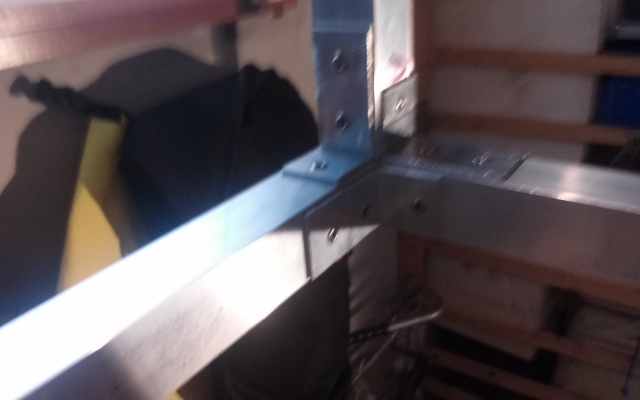

Since it is not really a teardrop but much more a small cargo trailer,
I do it as feedback on framing and skinning with aluminium composites.
And to show my kind of "French Touch" to the world !!! :D
Here is the starting point :
Box is 200cm x 120cm x 35cm - galvanized steel
Max payload: 350 kgs
I fitted it with alucobond panels, offered to me as they are, a bit used but for free !! 8)
Each one is 1m x 2m
To do the trick, I used an aluminium framing in 30mm x 30mm x 2mm
As I cannot weld aluminium, I simply puts many "pop"
Front side is only maintained by pop rivets for the moment,
I need to re-do it, rivets heads are too small, and I didn't put glue. :frightened:
For sealing side panels, I used a "SikaFlex FC11" cartridge, and XtraLargeHead rivets (16mm)
Sunny view of left panel done, and stuff back in place
The same for right panel
Till it will be used as a cargo, I added crate handles in each corner inside, and in middle of panels
Now, the roof is okay.
It was sealed on frame using glue "SikaFlex Auto/marine", and many rivets
Especially on front edge
But my idea was to fold a small part on front panel to be sure wind will not go between parts....
folding alucobond seems easy while reading datasheets, in facts, I failed.
Plastic part was not enoughly removed so folding the panel made aluminium skin to crack :cry:
Anyway, the build is not totally done, but I think it beguns to be nice when I put trailer and car together ! :D
