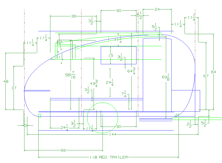

Now that I have looked a little more, I am leaning a little more towards the Benroy design. Where did you end up putting you window ac unit in that design? As I am looking at the design, I am having trouble figuring out how to fit it in.
Thanks
Tim

I think I drew a cross section of it... let me see if I can find it...
Postby mikeschn » Wed Apr 22, 2009 6:56 pm
If found this. It's close, although not exactly what I built. I stretched it out a bit, and probably tweaked the AC shelf height.
