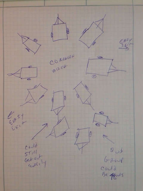

Postby Socal Tom » Sun Jan 25, 2015 8:15 am
Socal Tom wrote:
GreenViking wrote:What do you all think of the concept of teardrops that can be towed by not only cars, but for shorter distances by several bikes or even people allowing for placement in off road places.
I think you have them oriented backwards in this drawing.
1) people usually socialize in the kitchen
2) parking back to back offers some wind protection when cooking
3) it also provides a place to set a table for community dining
Edit
I've camped in groups in the outdoors for years. The natural tendency is for the group to form a circle, with the doors facing the middle, which becomes the communal area with a camp fire and shade structures. The rear kitchen
In the TD conflicts with this idea, so I still think back-in is more likely.
As far as the non-motorized movement, I think a hand break will be key. As well a clearly defined locations for pushing and pulling ( look at the T@B trailers ). The 1000 lbs or more will have a mind of its own in the small uneven areas of terrain, and it could be dangerous for the movers if there is no good control method.
The 9x3 concept is unnatural for most, because the inside trailer will be "trapped" in the middle. What I have seen happen are smaller circles ( pimples) coming off of the big circle.
Think a large radius made of a dozen trailers facing outwards, then a small circle of 2 or three between 2 of them.

Postby GreenViking » Tue Jan 27, 2015 12:46 am
Thanks Tom, I wanted to understand your words around the teardrop configurations that seem to work best clearer, could you post a simple sketch and snap it/upload it with a camera phone?
I am wanting to ad these thoughts to the designs and am quite the visual learner.
Also finding a way of breaking electric breaks while pushing a TD on uneven ground sounds good and not sure how to engage electric breaks once you have unhitched? Any ideas out there on that?

Postby Socal Tom » Tue Jan 27, 2015 6:38 pm
GreenViking wrote:Thanks Tom, I wanted to understand your words around the teardrop configurations that seem to work best clearer, could you post a simple sketch and snap it/upload it with a camera phone?
Thomas
Here is my lame drawing
