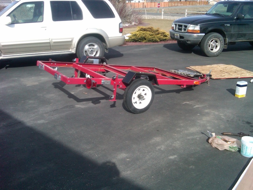

WOOHOO here is the start! By the way, how and when should I get this moved to a building thread?
Here is my trailer, with the lights and whatnot on, as has been the way since I built it 6 or 7 years ago.
And here is the 1/4" Luaun with 2x2 framing and a 2x4 in the center.
I also added 1.5" foam insulation in the gaps. Then I flipped it all over and added fiberglass resin to the surface to seal the luaun. This will be the very bottom of my teardrop. I have another 1/4" luaun sheet so that tomorrow, after I bolt this piece to the trailer, I can glue (liquid nails) the top piece to this base. I also hope to have at least one wall up tomorrow, if not both.

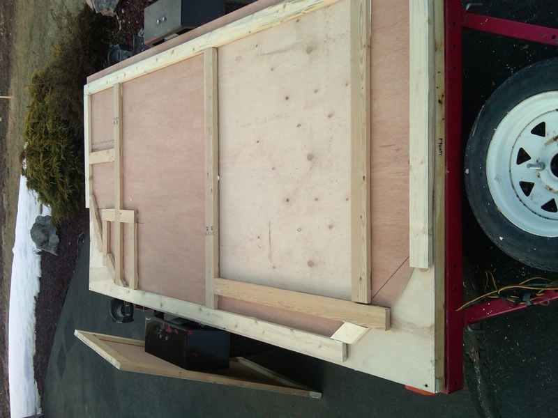

Alright, day three! Today I got a wall framed and the door cut out! I know it doesn't sound like much but it was supposed to be snowing today so I'm pretty happy. Now the bottom is sealed on the bottom, countersunk and bolted down, with the cabin side of the bottom glued on.
This is the wall
Hopefully this weekend I can get the other wall to this point and start investigating wiring. Then insulate and probably have to wait until the next payday!!
Then spars, ceiling, roof, hatch......At least it is starting to look like a tear!
