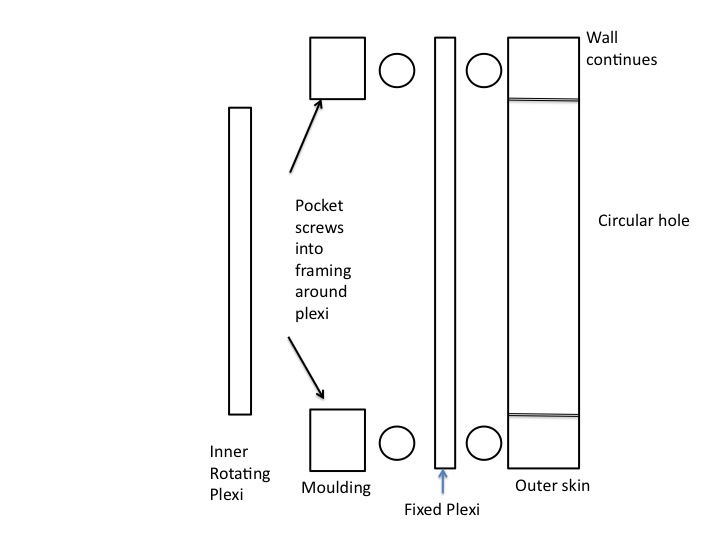

claw73 wrote:I have figured out how to build windows. I will be using the parmesan cheese tube top method where I have two layers of Lexan, with an inner layer that rotates and has parts removed that can align with the outer piece. Then the inside turns and is blocked against the outside piece. It's hard to explain, ...
something like SlyTerry's, right?
...and this next part isn't any better. I want to cut a 10" circle in the outside skin, place the outside square piece of Lexan up against the inside of the outside skin with a butt-load of silicone. Then I will place some 1/2" x 1/2" molding on the inside of the siliconed Lexan...
this is where i lose ya... i can't see the molding. i have a concept window going too and this is where i get stuck.
...with more silicone and screws going from the molding to the 1x3" frame that surrounds the Lexan.....anyway I'll try to get some pictures as I build it to describe it better.
waiting patiently
:dancing
Conestoga
Posts: 261
Images: 22
Joined: Wed Dec 30, 2009 12:01 pm
Location: Central PA
Postby claw73 » Tue Mar 30, 2010 10:53 pm
I hope this helps. Image
The molding is just so that it is less permanent and the plexi can be removed/reinstalled if broken without ripping apart the entire wall. Just in case.

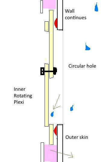

Postby Conestoga » Wed Mar 31, 2010 9:30 am
claw, thanks for the useful drawing. :thumbsup:
i too am attending the "bobhenry school of architectural design"
so i fired up mspaint.exe
there is the opening in the outer plexiglass.
inevitably, moisture is going to get in between the layers of plexiglass.
an area of interest is the lower edge.
any weatherproofing (in red) on the outer plexi will hold that moisture in. i think.
there will also be condensation from the inside of the cabin.
the desired path of drainage is indicated by the arrow. "weep hole"

Postby claw73 » Thu Apr 01, 2010 8:31 am
Thanks Conestoga, that drawing is much better than mine. What is a common way to add a weep hole to the windows?
claw73
Posts: 64
Images: 28
Joined: Tue Feb 23, 2010 5:35 pm
Location: Bozeman MT
Postby Conestoga » Fri Apr 02, 2010 10:22 am
claw, i have no idea. i've never built a window (that opened) before.
my first thoughts are to just put a little drain channel there, the size of a
drinking straw, angled down and outward. and plug it with a pencil when the
trailer is in storage so wasps don't move in....
