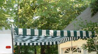

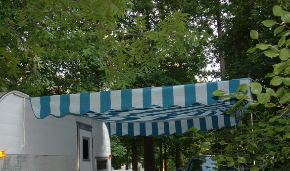

Postby mikeschn » Wed Aug 27, 2008 5:04 pm
Kristi,
I'd like to see something come of this. Do you have some pictures of other awnings you make?
P.S. Do you make TD covers too?
Awning
Postby Kristi Foster » Wed Aug 27, 2008 5:43 pm
I just did the tutorial to make the image smaller. Now I have to figure out how to post it. ImageImage

Postby mikeschn » Wed Aug 27, 2008 6:01 pm
Kristi Foster wrote:I just did the tutorial to make the image smaller. Now I have to figure out how to post it. I am not computer literate!!!!!
Posting it is easy once you've done it a couple times... The help is up there in the menu.
Do you do sunbrella?
Awning
Postby Kristi Foster » Wed Aug 27, 2008 6:09 pm
I have successfully made an image in my personal gallery. Yeah! The awnings I make are made of sunbrella weatherproof material. I am presently trying to figure out what type of awning would work on a tear drop. They are so small and rounded that I think one coming off of the hatch might work the best. I just started inquiring today as to where an awning rail could be placed.
