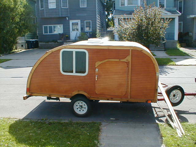

Hi everyone, I just completed the maiden voyage of "My Summer Project", (afterward referred to as "MSP"), and can report about 90% success. The weekend we took MSP to a local State Park was rainy. In fact it rained both nights, continuously on the second night. Needless to say my apprehension level was through the roof, expecting at least one leak and fearing a deluge. Neither drip nor flood occured, much to the relief of Mrs. Buffal Bill. Not only did the roof not leak but it withstood a direct hit from a dead branch that fell directly on the roof during the night. :? And not a single scratch on it. :shock: The branch was about as thick as a person's forearm and about 7 feet long.
Any way here's a pic : Image
I've had to pretty much do all the building in the street :thumbdown: since I have no driveway or garage. Makes things a little difficult considering I have to pack up all my tools and supplies everyday. It's also nearly impossible to work in the rain, and here in Buffalo we've had rain about 3/4 of the days. (You folks in Seattle must have passed the curse Eastward)

Hi Bill, your TD is very nice. So glad you had no leaks and especially glad the limb did no harm. You really know how to break one in.

Kudos to you for building without a garage / shelter!!! It looks really nice. :thumbsup:

Yes indeed! That is a nice job on your summer project. :thumbsup:

Good job, Bill! The beaded paneling is a nice touch. I like it!

Bill what is the siding The side looks like 2" plybead but the hatch looks like basketweave what is it and where did you get it Thanks
The siding and hatch are both beaded birch paneling from Lowes. I used the one with no finish on it, (oddly, it was costlier than the pre-finish), because I knew I'd be adding urethane marine spar varnish. All the walls, floor and ceiling are a sandwich construction with birch-foam-luan layers. The roof exterior is FRP, (fiberglass reinforced panel), also from Lowes. Because the FRP has no UV protection I added two coats of industrial 2-part epoxy paint. The trim is cut, (somewhat sloppily), from 6 inch wide cedar, for rot resistance, that was a closeout item from ...... you guessed it; Lowes.
