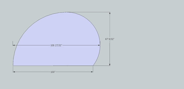

I can't quite figure out the profile I want to use but I had hoped to base it roughly off the "golden spiral". Some quick figuring tonight on sketchup led to this: Image
I realize that the height is very untraditional. Can you all comment on what advantages but mainly disadvantages such a profile would afford me? I had planned on skinning in Al so right off the bat I know there will likely be issues there. For the wood underneath I feel comfortable that splicing ply together (with splines) would be a reasonable option. So, please comment on the Al issue but I'm more looking for other issues I may not have thought about. Having never actually seen a teardrop in person, much less build one, I'm sure there are plenty of considerations that I can't even imagine yet.
If the height of the profile is too much of an issue I plan on just cutting off the bottom to reach the standard 4' height....or closer to it at least. I do want the walls to cover the trailer frame but still maintain roughly 48" from the deck to the roof...so maybe an overall height of 53".

Chubby is 120" long and 5'7 wide by 61" tall .....
That 61" covers the frame and sub floor with about 1 1/2" as an apron below the frame using up approx 5" total. I also lose 9" to the mattress. So effective head height mattress to roof is 47" If I had an inside skin it would become 45" Setting upright on the mattress I can not reach the grab bar I have installed on the ceiling spars without a little bounce.
There are good points and bad points about this height. I installed all my electrical setting in a camp chair inside the tear with more than ample headroom. A draw back is cold weather camping (zero to +30) the heat at the bed might be 40 and at the roof it can be 90+. You have to press a fan into service to keep the stratafied air moving. Also the bigger the cube the more heat ( or cool) it will take to get comfortable.
My 4x8 HF frame was badly bent when I purchased it for $75.00 so I pressed a dock handrail into service to replace it and just used the axle assembly and the tongue.
Here is the profile I think it looks fat Hence " Chubby"
Galley is only 2' deep but quite adequate I left the 2x4 framed galley wall open for a pantry that closes with the flip up counter.
Here is the grab bar inside great for a steadying help moving in the trailer or just a place for hanging clothes in transit.
The HF tongue in my opinion is a bit weak (and a bit short) for the 1100 to 1200 pounds you are planning. Here is a good method to reinforce it . (thanks Harvey)
I would recommend you do it very early in your build.
As to cantelivering the body Here is a shot of 2' hanging in mid air. Look closely at the front of the Barn
The good thing is there is no wrong way to build a tear just do it your way. With your building skills you will have few problems and remember all you have to do is ask and 8000+ folks will give you a parcel of answers to select from. :thumbsup:

My planned build will also have the "box" hanging over the frame in all four directions. From what I've seen, as long as it is solid, there is not an issue with this.
