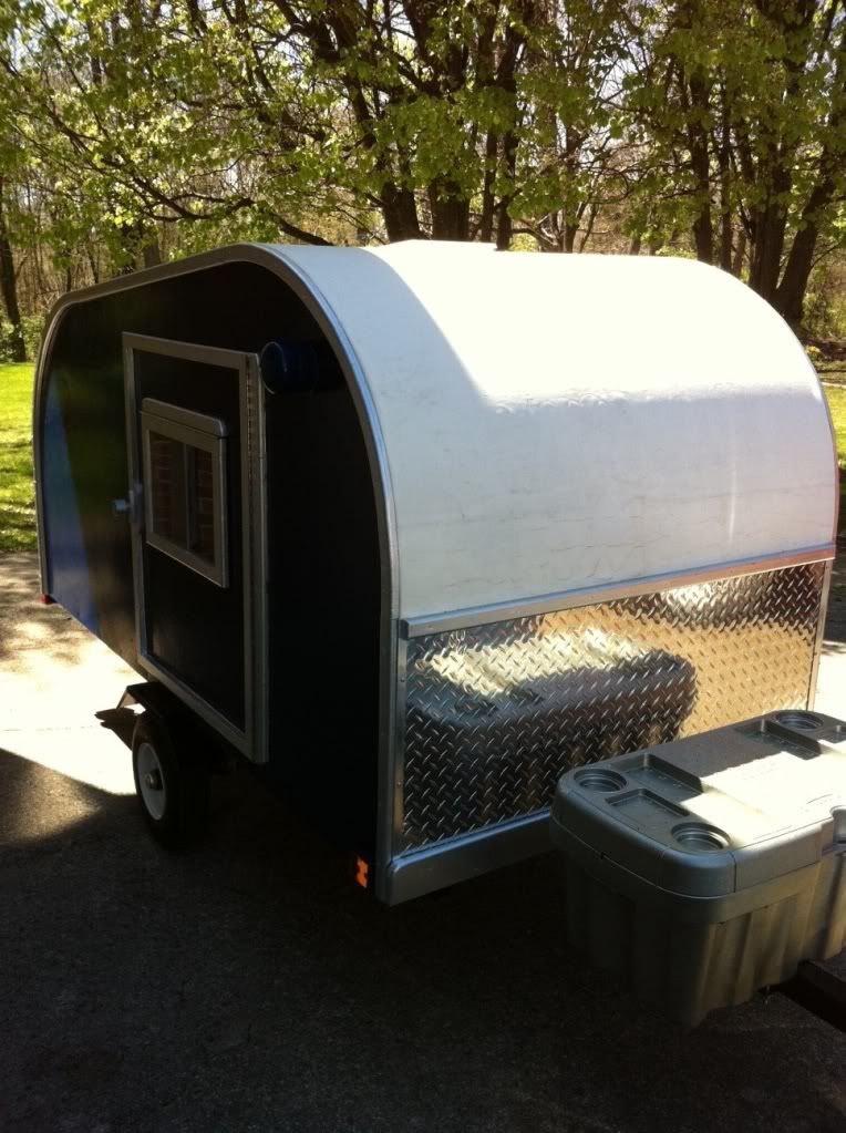

I just finished my teardrop. It is 8' x 4'. No galley. Just a bed and two shelves inside. Took my dad and I two weeks to build it. Pulling it with my smart car. Less than 400 pounds total. This is the only picture I have of it so far. :D

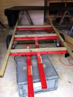

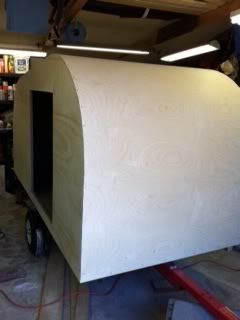

Thanks! I know, the car is smaller than the teardrop. I built the teardrop specifically to be pulled by this car. It pulls it well. I am including some pics of the build. I used a small Harbor Freight trailer to build on. I did have to end up putting a different, stronger length of steel for the tongue. I built an extended frame using 2x2's. The floor is 1/2" plywood. The walls are 1/4" plywood. The roof is 1/8" plywood. I covered the roof with rubber roof material for motorhomes/campers. I put a 2' high section of diamond plate on the front. The colors are blue and silver to match the car. I'll take better pics of the outside this weekend and load them up.
Here's the trailer and 2x2 frame.

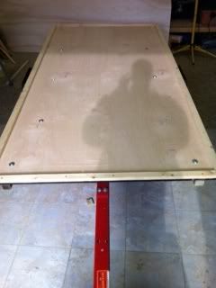

Here's with the floor on. I put tar on the bottom of the floor. The entire camper got treated with CPES.

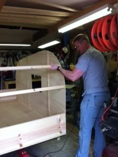

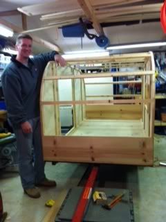

The build continues:
And continues:
1/8" plywood bent easily and is strong.
Finished product again:

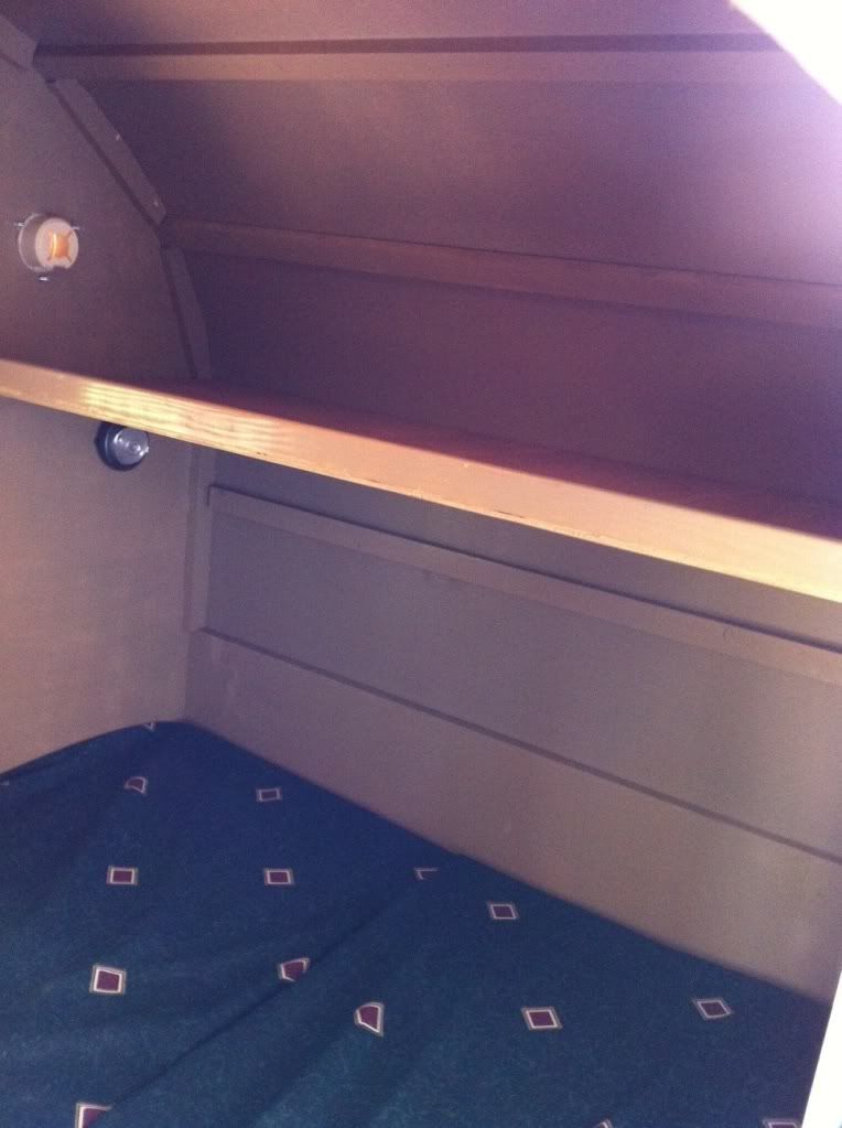

Foot of bed:

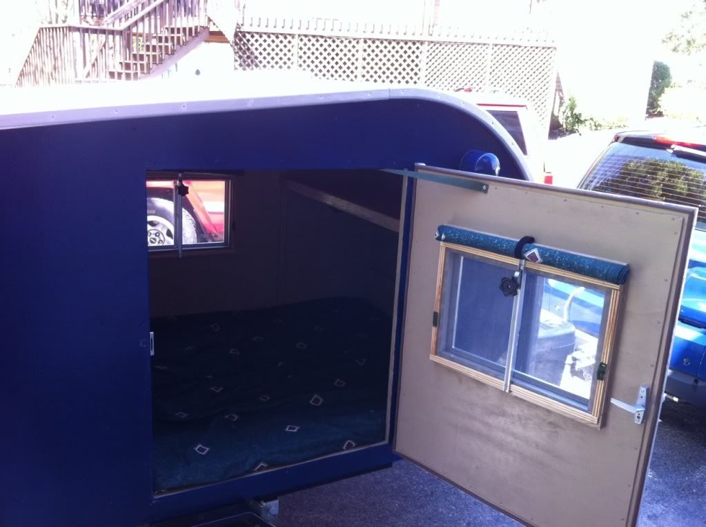

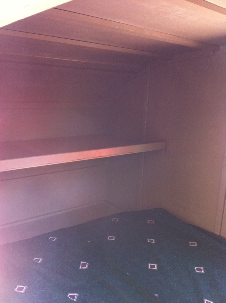

Head of bed. I made the bed so it can fold length-wise to make a couch:
