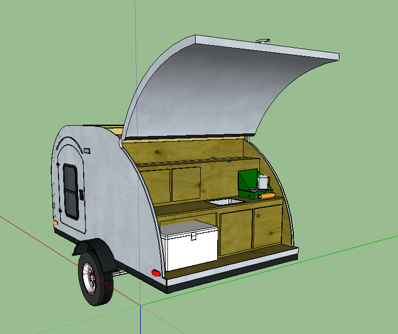

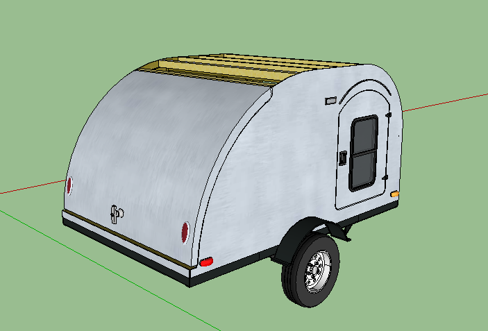

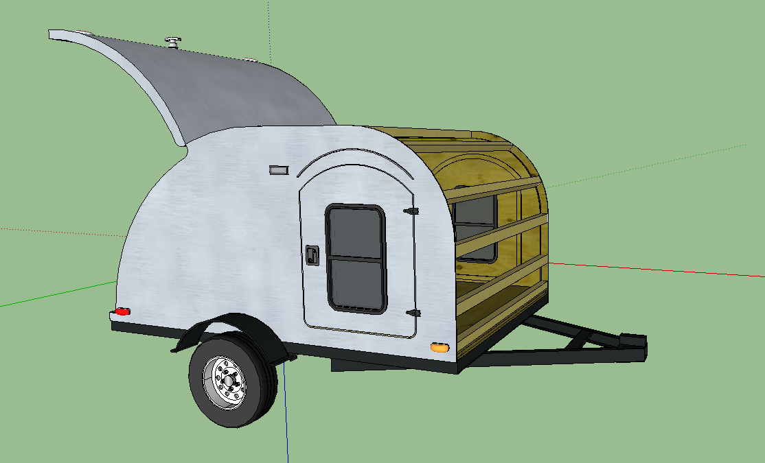

hartk1213 here i am a new comer and i am just introducing myself i have never built a teardrop before but i am an avid woodworker i am going to start building my TD after the new year
i have started designing it
here are a few screenshots of my sketchup plan...
also fyi since i designed this i have change my profile to match the generic benroy profile
let me know what you guys think

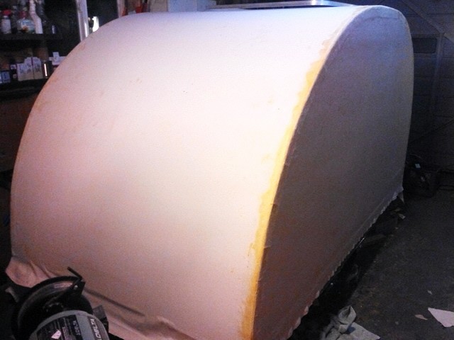

Think twice about the bottom of your hatch seal. On my first build, I did it the same way––bottom of hatch mates with the top of the floor surface. But water likes to capillary along the seal at the bottom, even though the seal is "squished." (Another reason I coat the galley floor with epoxy.) I've got it fixed now with a longitudinal rubber seal at both ends, but there's a better way.
On builts #2 and #3 I went with this. The bottom of the hatch is pulled against the seal on the rear of the floor and stays dry.

oh ok cool thank you i think ill change it when i go to build it ..i didnt think of that
