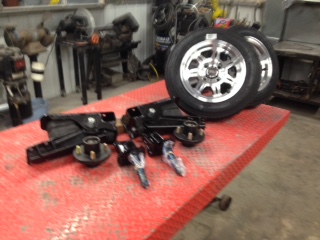

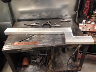

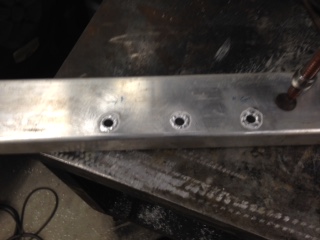

Postby Sarge 51 » Mon Dec 21, 2015 9:34 pm
First are the Timbren hubs and 4 on 4 wheels and tires. Then the start of the frame rails Note I made sleeves and tig welded then in so the tube wouldn't crush. You see the progression however I am going to shorten up the drop at the rear by 4 inches. Will post that pic as soon as its done.
Frame rail
frame rail.JPG (35.5 KiB) Viewed 1308 times
Sarge 51
Posts: 41
Images: 11
Joined: Wed Dec 16, 2015 6:01 pm
Location: New Berlin, Wi

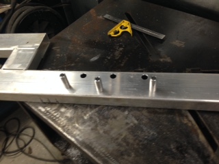

Postby Sarge 51 » Mon Dec 21, 2015 9:36 pm
More pics
mnt rnf weld.JPG (28.16 KiB) Viewed 1308 times
Sarge 51
Posts: 41
Images: 11
Re: New Guy
Postby Sarge 51 » Mon Dec 21, 2015 9:37 pm
Sorry but not sure how to attach more than one photo at a time
mount reinf.JPG (31.69 KiB) Viewed 1308 times

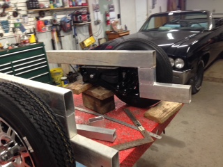

Postby Sarge 51 » Mon Dec 21, 2015 9:39 pm
Bear with me
seting up frame rails.JPG (43.39 KiB) Viewed 1308 times
Sarge 51

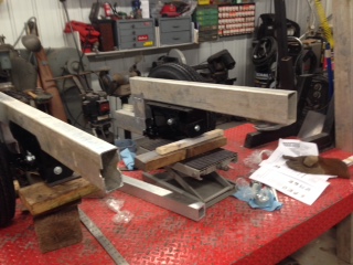

Postby Sarge 51 » Mon Dec 21, 2015 9:41 pm
Here we go again
ready for tongue.JPG (101.06 KiB) Viewed 1308 times
Sarge 51

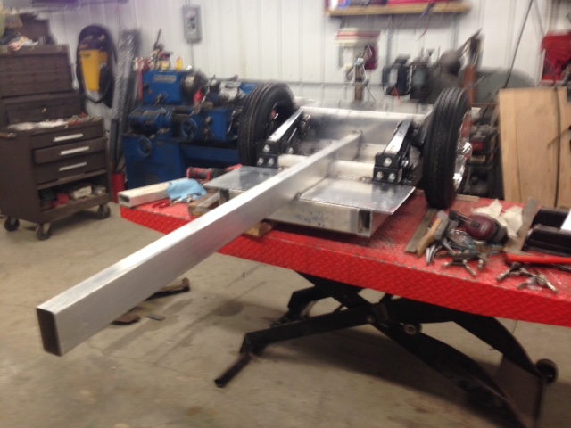

Postby Sarge 51 » Mon Dec 21, 2015 9:42 pm
Almost done
tongue mounted.JPG (100.52 KiB) Viewed 1308 times
Sarge 51

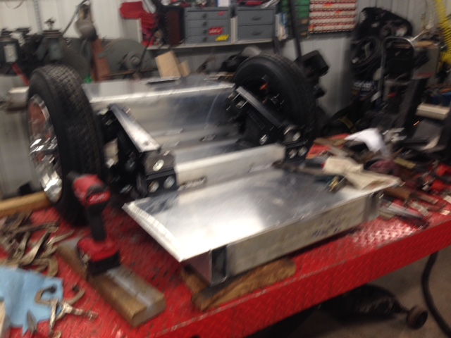

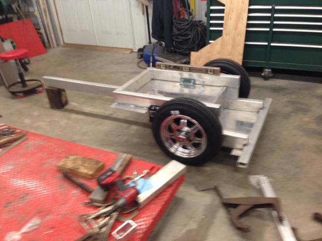

Postby Sarge 51 » Mon Dec 21, 2015 9:44 pm
Ok last one for the night. Here it is on its feet. A lot of work and design left but I am a design as I build kinda guy.
first time on wheels.JPG (102.13 KiB) Viewed 1308 times
Sarge 51
