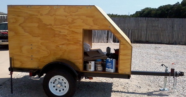

* I went the full route using the "mix", with 25/75%, 50/50%, 25/75%, then finishing with 100% poly. Two coats of each, to ensure penetration (best as I can remember). I didn't do it this way without reason, though, but because I was violating the instructions, and coating the previously un-prepped bare plywood (it was pre-sanded, with phenolic resin between plies, so all I did was wipe it down with thinner, to remove dust/fingerprint oils from construction) in direct sun, in 106-110 degree heat.
* The "mix" was soaking in so fast that I wanted to make sure it was not just evaporating, but truly penetrating the wood. Each successive layer took me under a half-hour, and it was complete before dark (started after noon). The end result looked so good that I almost wished I hadn't already planned for (and bought) three different top-coat paints to cover it, since I used Minwax Fast-Drying poly -not UV protective-.
at end of poly coating, day one.jpg (83.65 KiB) Viewed 3537 times

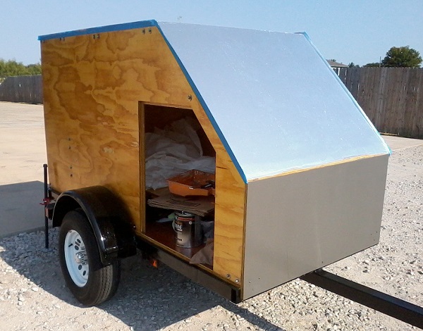

* I pushed it back inside the shop, where it cured for a week, then top-coated the poly with "Massey Ferguson Grey" Valspar Tractor & Implement Enamel (on sides and lower front), Valspar Heavy-Duty Aluminum Paint (reflective "silo" covering, for upper front, roof, and hatch)), and Rustoleum Black Enamel for edges. Same conditions applied, very hot & sunny, and the results were great. I let it cure another week before I touched the trailer again.
starting the grey and silver topcoats.jpg (106.02 KiB) Viewed 3537 times
* Since it was painted in 2012, I've re-touched the front slope and rear hatch, to cover-up incidental contact blemishes/road damage, but there's never been a hint of paint/poly failure, water leakage, or chalking, in the 6.5 years since then. I think the use of the "mix" is the best prep you can do for a plywood surface, better than any wood primer I've ever used. I violated logic in the way I applied the coatings, but it worked!

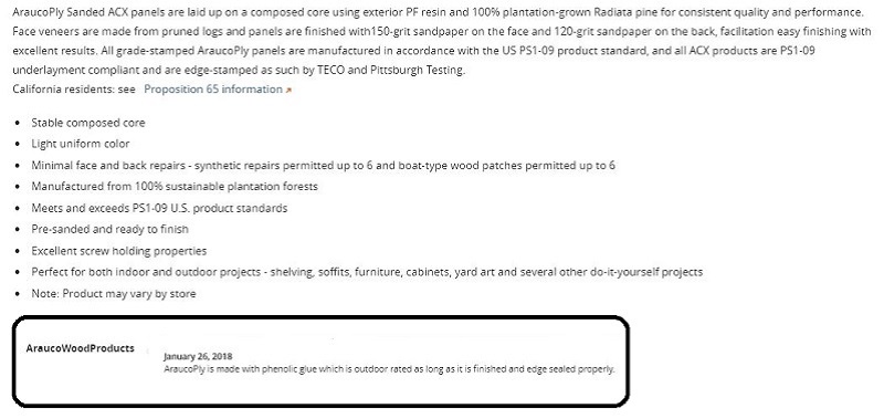

* It wasn't siding, but a "Radiata pine" plywood I got for $25 per 4x8 sheet: "Arauco" 3/4" plywood, which their website said had minimal face & back repairs, pre-sanded front & back, and used a phenolic resin (impervious to water & most common chemicals). Not as hard a plywood as the birch I started my floor with (topped with Luan), but since the wood was to be coated with many layers of poly, & outdoor equipment-type enamel, I'm sure it is as hard or harder now than before.
* There's been no sign of deterioration, as I stated, so the discounted plywood turned out as good as the birch plywood I had intended to use (I only had one sheet to start, but bought six substitute/additional sheets, used for exterior & interior, both) to complete the trailer.
