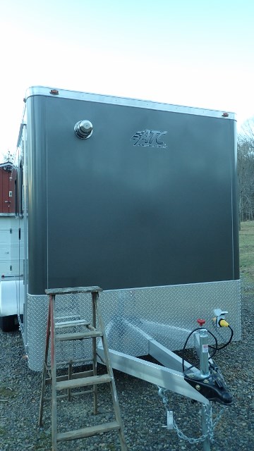

My next consideration is up front. If I have a typical flue/vent cover on it and the cover is facing forward of the trailer, will I have an issue with excessive wind or water getting into the flue while driving? Of course, the heater will not be on during travel.

Postby Gonefishin » Tue Jan 06, 2015 7:51 pm
I wouldn't think it would be an issue Bob. With my side mount, I don't get any water in, or dirt, even at 70-80 mph on the interstates. I would think there would be a little less air flow on a nose mount, and the flow would be pressing the cap straight against the trailer skin. The Dickinson weather guard is pretty bomb-proof so far.

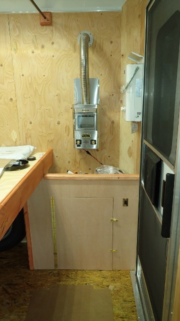

This one is mounted on the front wall.
viewtopic.php?f=42&t=61833&start=30

Postby lrrowe » Tue Jan 06, 2015 10:56 pm
I remenber that one too. I Think that is where I got the idea for mounting the heater in the front. I will drop the poster a PM.
