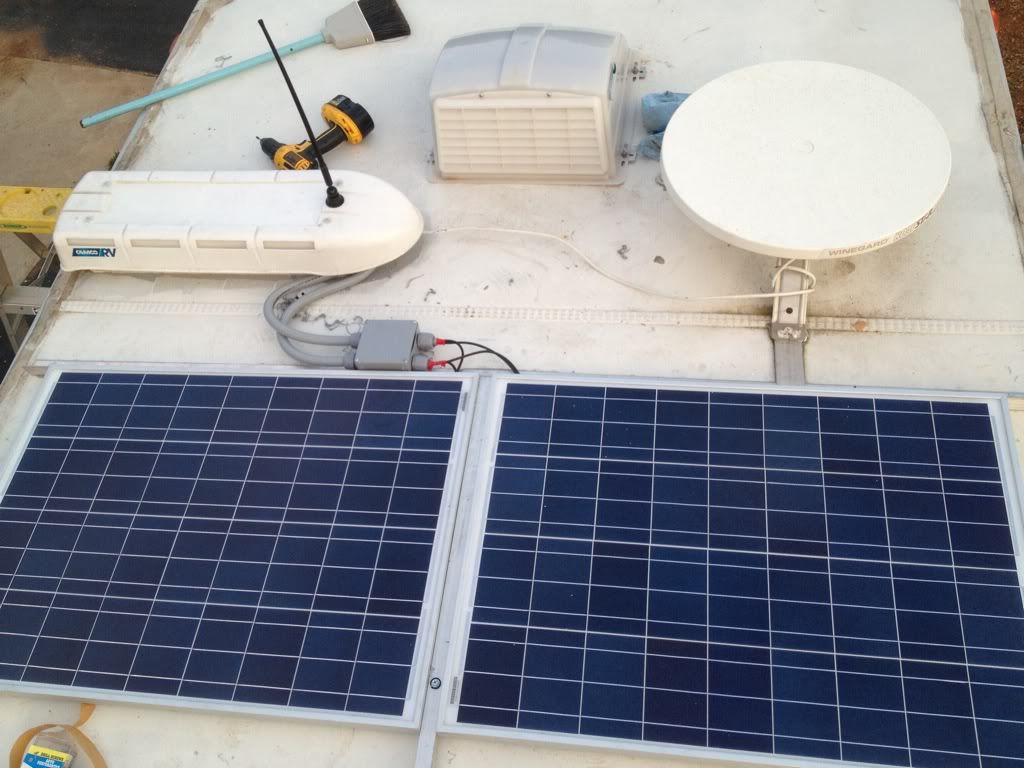

bdosborn wrote:Where are the pictures of the solar panels? Got to have pictures of the panels!
lol Sorry I forgot to post some on here. I had a small set back with the other two panels I had ordered.. Apparently the order got held by customs for a week or so just long enough for the tariff to go into effect. Solar blvd is not sure when they will get them back in stock now.. Kinda of sucks cause I made my mounts with 4 of those 80 watt panels in mind. So far the two has worked really well though. Four of them is probably a little over kill, But at the same time we haven't used them with much overcast or during the winter yet. I've been keeping an eye on their site they said they are looking for a new distributor for those panels. With me already having two of them and having the mounts made for a panel that size I'd still by the same panels even if they are a little more expensive.. Not sure I'd pay another 30% or so though.. That Tariff is pretty frustrating. The more I read about it the more :x I get. It pretty much won't do anything but make us the customers pay more for solar in the mean time till the companies in china come up with a work around. Even then the panels will probably be slightly more expensive but still much cheaper the US made panels. So it pretty much won't help the use market but will force us to pay more for the same china made panels.. Nice...... lol anyway sorry for the rant here is the only picture I have so far.. I was going to take one once all the panels were up there. For now the wires into the junction box is just taped up. I was going to silicone them once I wired all 4 in.
