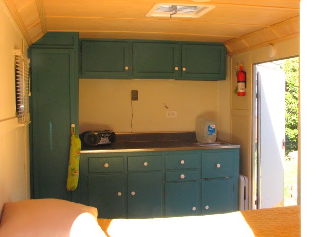

Bought the trailer in June of 2009. It was a minor custon build. Added 6" in height, flush lock on the door, brakes and rear jacks. Threw a futon bed in it and went camping.
During the winter I planned the conversion and started accumulating materials. First thing was to gut it and insulate.
After wiring, the original plywood went back up on the walls.
When I was by the dealer one day, I bought another cam bar hasp. It was $6 I think. I liked the idea of using an eyebolt, but that meant buying a lock with a longer hasp and one more key to keep up with. This way I can use the padlock I already had.
Walls were painted with paint left from upfitting an office space and an old base cabinet was repurposed from the basment.
Supports added for the bed.
Ceiling panels.
Bed platform, 3/4 inch plywood recycled from a basment closet, with plenty of room for storage beneath.
Wiring routed to where I will build a closet and install the AC/DC power center.
Built an enclosure to support the air conditioner.
Added wall cabinets, smoke detector and small fire bottle.
Ceiling
Countertop painted with Rust Oleum countertop paint. Half steam table pan for the sink which drains beneath the cabinet to a 5 gal paint bucket with lid.
And there you have it. It is a very comfortable little home away from home. Everyone who has seen it has been very complimentary. There are still a few tweaks to be made, likely some I won't discover until I use it more freqently.
Thanks to everyone in the forum for the ideas. Watching your builds really inspired mine.

Postby WA » Sat Oct 09, 2010 8:15 pm
Thanks for the compliments everyone. It really is a very comfortable trailer. The green is a Pittsburg Paint color called Teal Zeal. In my mind it was very retro, which is why I chose it.
Pete, the bed in the picture is a double. I am 6'4" tall. I bought the 7 wide with 6" additional height so I could put a queen mattress in and be able to stand up. The double sized futon was already in the basement and didn't require the additional outlay of dollars at present. We will be replacing a queen mattress in the house later this year and the bed platform will be reconfigured to accomodate that footprint.
I do all of my cooking outdoors, save for making coffee each morning in my Aeropress (which I wouldn't have discovered if it had not been for this forum!) There is enough storage space under the bed for my stove (Camp Chef) and an EZ-Up, plus other totes that are carrying what I need for that particular trip.
On mothers day 2009, I woke up in my tent at the race track about 6:00AM. There was dew on my face and my butt was on the ground because my air mattress leaked down overnight. While I struggled to get dressed for work that day, I was determined to find an affordable solution to that predicament.
I had a blast building this thing, and my decision to do this is reinforced each time one of the guys at the track with the $150,000 plus motorhomes ask to look inside and and say that "...this is all you really need."
Most folks don't realize that they can do this on their own. It doesn't take skillsets that are out of reach of the average person who has desire and perseverence. You just gotta do! And when you get stumped, ask this forum. Folks here will help you. Thanks again!
