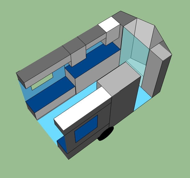

I've just started playing with Google SketchUp and here is the concept.
In the front center is a shower stall. 30" deep at the V by 36" wide. On either side will be storage. On the right is a 32" door and just to the rear of that is more storage and the 5.5cu/ft refrig. On the left side will be 6' of counter space containing a small sink and a 21" range. In the back is a fold down dinette for sleeping and eating.
Heat will be supplied by a standard RV furnace and more then likely A/C by a roof top unit. Our pups will be living here full time also so we need to keep the interior a good temp for them.
AC power will come via a 2000watt generator or 1000watt inverter and DC by a 100-200ah battery system.
Fresh water will be from two seven gallon water jugs with one for the sink and one for the shower. Water will be supplied by foot pumps just to keep things simple and less drain on the batteries.
Sheesh....that sure seems like a lot of work once I wrote it all out!
Just a quick recap on what we plan on doing. We will be living full time in our conversion for at least six months starting sometime after the first of the year. We will be traveling around the country, parts of Canada, maybe Alaska and, if things calm down, Mexico. We love skiing, climbing, hiking, surfing, pretty much anything outdoors. We also plan on visiting friends and family and at some point get in a little relaxing. Occupants will be myself, girlfriend and our 85lb Gordan Setter.
More to come......

Postby pete42 » Tue Oct 12, 2010 3:12 pm
Seems like a lot to fit into a 7X12
I, like others will be waiting to see lots of pictures, me because I too want a 7X12
I also want a ramp door so I can carry my mobility scooter.
Now I have to unhitch the trailer from the truck unload the scooter then reload everything.
some will tell you they like 6 foot wide because it's easier to see around, me I want the room the extra foot gives you.
I do wonder about running an air conditioner using a 2000w generator.
lots of luck to you and your friend keep us up to date.

Postby d30gaijin » Tue Oct 12, 2010 8:05 pm
TurboandMe,
That's a great looking CT setup on a very nice trailer but your build is rather aggressive. For starters, if you're planning a roof type typical RV air conditioning unit you'll need more than a 2000 Watt generator. A 3000 Watt would be minimum. You might want to reconsider going with a window type home AC unit from Home Depot or Lowe's, or something along that line in about an 8000 BTU unit, they can be powered by a 2000 Watt generator and something you'll find a fraction of the price of any RV roof top type unit, RV roof tops types seem prone to failure too often considering what they cost.
In the words of "GPW" a great poster here, and a practician of simple i.e., "Keep it simple." Avoid RV specific appliances, rather go for small appliances you can find at Home Depot at 1/4 or less the cost of RV specific stuff. If you mostly plan to camp/park where you have 110v power buy a cheap Sears 5.5 or 6 cu. ft. dorm style reefer. You can buy five or six of them for the cost of a single RV reefer of the same size (I paid $149 for my Sears reefer). The same with a water heater. I paid under $200 for a 4/6 gallon "At point of use" water heater. An RV specific water heater costs two, closer to three times that.
Just some things to keep in mind for your CT conversion.
Don

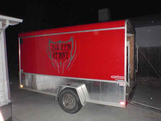

Postby TurboandMe » Sat Oct 30, 2010 7:56 pm
So we have our trailer.....and its not new. We talked and looked and finally decided to try and find a used one. After calculating the expense of a new trailer it just seemed unreasonably expensive. So we searched craigslist for weeks trying to find the perfect trailer and finally one appeared. It is a 2003 H&H 7x12 with a 2' V-nose, ramp and single torsion axle. In its previous life it was a motorcycle trailer hauling dirt bikes to the track and back. The owner managed a spectacular fall and after fracturing his neck was getting out of the sport.

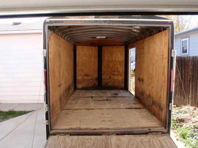

Without further ado....here is our, soon to be, new home!

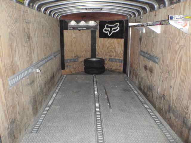

And an interior shot before I tore it apart

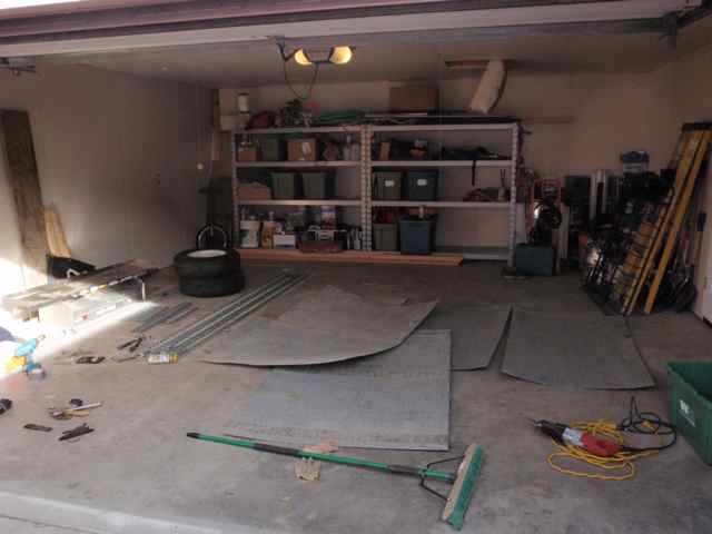

Well I purchased the trailer on Thursday night at about 10:00pm. After getting it home and inhaling dinner I set about removing the diamond plate and E track from the floor. The diamond plate was glued down with gallons of liquid nails and the E track had at least 10,000 screws in it so by 3:45am the next morning here is the finished result.
And here is the stuff that was removed....somehow I'm not sure the garage is going to be of much use for the next few months :roll:
That's all for now. But on Monday I will be pulling the 3/8 ply from the walls and the treated 3/4 from the floors. I will be replacing the floors with 5/8 and the walls will get the usual insulation treatment.
On a side note we took it to the CAT scale down the street and weighted the beast.....you get where this is going. We were hoping be sub 2,000lb but sadly we were at 2,400.....OUCH! Hopefully downsizing the plywood will help our weight issue.
All in all we are very happy with our new house and are quite excited to get going on the project.

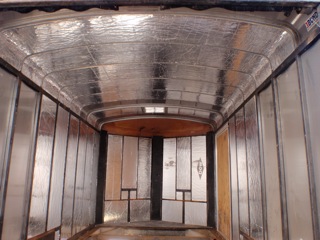

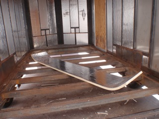

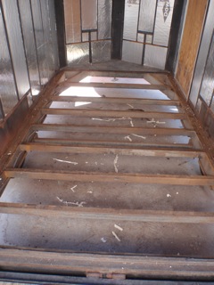

As planned monday was a good day. More precisely monday night was good. Started by stripping out the 3/8 from the walls and the 3/4 from the floor. I weighed a piece of 3/4 and at 4x6 it was 85lbs. Hopefully we will loose some weight by not reusing that again. Then it was on to installing the insulation. We went earlier to HD and got foil faced 1" and the pink board 1/2". The plan is to start with 1" in between the studs and then cover that with the 1/2" for a total of 1.5" of insulation. We will not be covering that with anything other then wall paper or possibly the Titebond II and bedsheet mix I've read about here.
On to the photos.....
Here's how it looks as of now
It would have been much easier with a floor but oh well!

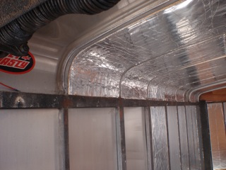

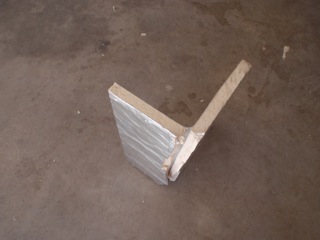

I figured out that I could bend the foil faced 1" foam by hand and have it match the curves of the ceiling. If you worked at it slowly it actually wasn't too hard.
If you tried to stretch the shiny side it did this....only the duller side with stretch and not break. I found that out on accident.
Once in place it turned our pretty good I think
