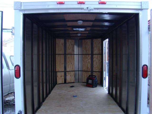

I just wanted to say thanks to everyone who has posted to this site, without it I could not have completed my own conversion. When I set out on this project I thought I had a unique, one of a kind idea. In the end, I am glad I was not alone, the help I have found here has been invaluable.
So now I am ready to give back. I have completed my conversion and posted pics in my gallery. If I did not post something right or you can't get to the pictures tell me and I'll post them directly in here as well. If you have any questions or need more pics of something just let me know. I've used the camper for a full year now so I have a few suggestions and things I would do different if I were to do it again. Once again, thanks to all of you who have posted your own builds, it has helped me tremendously.

Postby MtPhishPhan » Tue Mar 08, 2011 9:23 pm
The biggest problem I've had is with the ceiling, I used some tan speckled egg pattern paneling I found at Lowes. It looked great but over the past year has absorbed moisture from condensation and started to warp. My ceiling is now all wavy. I'm in the process of taking that out but haven't decided on a replacement.
I was thinking about using some white, textured, plastic like panels they have at Lowes but they are normally attached with plastic rivets and adhesive and that isn't going to hold on the ceiling of a camper bouncing down a dirt road when it's 20 degrees in the middle of hunting season. I would just screw it but screw cover caps run 70 cents a pair so that would cost a small fortune. If anyone has any good ceiling ideas I'd sure love to hear them. What ever I use has to have some flex as the roof is slightly bowed.

Postby Nathan N » Wed Mar 09, 2011 6:11 am
MtPhishPhan wrote:The biggest problem I've had is with the ceiling, I used some tan speckled egg pattern paneling I found at Lowes. It looked great but over the past year has absorbed moisture from condensation and started to warp. My ceiling is now all wavy. I'm in the process of taking that out but haven't decided on a replacement.
The ceiling is why we ended up with the paneling we did. It was true ply and not press board with a face on it. I figured that would be better for the ceiling. Donna liked the looks and wanted it for the walls so that's what happened.
Someone had some thinner strips (in thickness, I think it was wood) that appeared to be 2 or 3 inches wide that they used to cover the screws along the ceiling rib. It was attractive in a contrasting stain color. I was going to do something similar but haven't yet. I just used brass screws along the ceiling ribs. Haven't camped too much in real cold weather but so far haven't had condensation dripping from the screws. I figured if I did I could retrofit the ceiling trim strips.

Postby MtPhishPhan » Wed Mar 09, 2011 7:59 pm
I think I'll go with the real birch panels on the ceiling like I did on the walls, thanks for the suggestion. I originally wanted to break up the wood on the walls with something different but I think it will be fine.
Thanks for the link to the snap caps, they're over 2/3 cheaper and way more of a selection.

Postby Kyle1911 » Mon Mar 14, 2011 9:04 am
Phish, I'm glad I read this post. I was about to buy a bunch of the paneling from Lowes. Probably the same stuff you used. Just wondering if you have insulation in your trailer? You said it warped from condensation. Was that from people being in the trailer, with no insulation, or just accumulated moisture over time? I want the "Factory built" look for the walls in my build, but I'm going half nuts trying to find paneling here in Washington State. I wonder if Luan, sealed, with vinyl wallpaper would do the trick? Thanks, Kyle

Postby MtPhishPhan » Mon Mar 14, 2011 12:15 pm
I used real 1/4" birch on the walls coated with 2 layer of polyurethane and they have had no problems. I have everything insulated except the doors and the floor, that is my next project. I camp from -10 to 80 above and use a Mr. Heater when it is cold, that's when most of the condensation occurred.
I just finished my ceiling again and this time used the birch. It was easier to work with and I think it came out better. With the screw caps I won't have any metal exposed to the outside and inside air so condensation should be reduced.
Anyone have any information on insulating the doors? I was thinking about having the blown foam thing done to the underside of the whole camper and was wondering if a guy cut a little whole in the door paneling if he could fill that up that way. Anyone have any experience with this?
