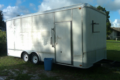

Finally able to get to work on my 8'6" x 20' Toy Hauler :D I have a trip coming up in August, which in Florida is ONE HOT month. 8) So I'm trying to get this thing from a landscaper's trailer to an AC'd toy hauler by the 20th. We pulled all of the wood from the inside over the past week. Still a little in the front, but I have to pull down the shelving to do the rest.
Using a heat gun and scrapers, my girl and I were able to remove all three sides of decals from old lawn business that used to own this thing. Thats alot of lettering! :thumbdown: While I was pulling on some vinyl decal, it tore, and the paint scraper was in that hand... so i punched myself in the face with a metal scraper yesterday :applause: cut my nose, but otherwise ok. Don't run with scissors and all...
The old cam hasps on the back had been run into and bent, so I replaced them today too. Had to grind the bolts off...
All of that done, the day seemed early, so I decided to tackle the Rv style door latch. As soon as I opened the door, I saw a chunk of steel in the way where the old exterior handle was attached. So I broke out the grinder and went to work.
Jumping from that pic to this one, in no way conveys the trial and error of using a sawzall, a grinder, a dremel, and a jigsaw to make these happen.
On to the Door frame. Broke out the square drill bits... DOH! No square drill bits around, sooo, I drilled this one out with smaller bits, then used a screw driver to beat it sort of straight.
Not perfect, or ideal, but a file will straighten it up.
Here's the exterior pic of it installed. I forgot to put the cam hasp back on. Do that tomorrow :thumbsup:
Inside the door once the screws are in
And the overall Port side of the beast. It is 8' tall BTW.

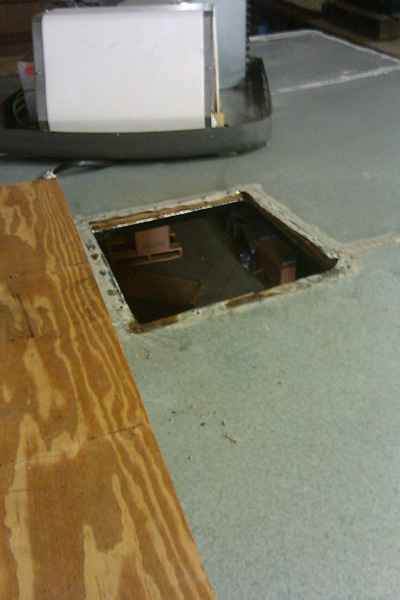

So, got some work done today. Combination of heat and rain have been a major hold-up lately. I had one of our office warehouse bays emptied so I could work on it indoors today and for the next week.

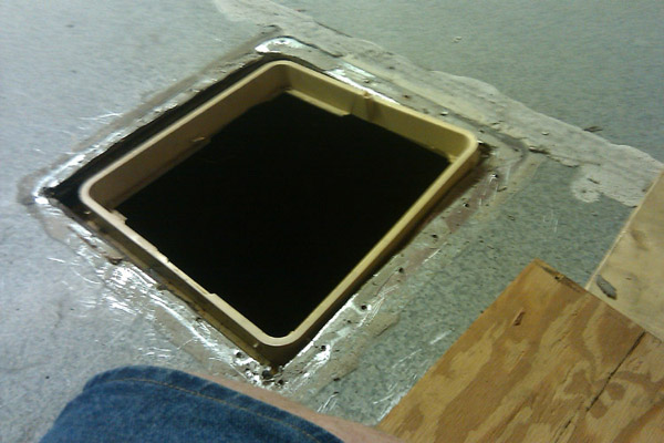

I removed the existing vent and curb to reveal some rust. Not the best news obviously.
The front vent opening is much better
I'll be attaching everything tomorrow. Removing those was one heck of a chore. They were REALLY attached. On a bright note, the frame held me, and at 335 lbs, I'd say that's a good frame :thumbsup:

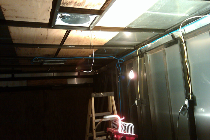

Alot of wiring. The blue is a 10/3 extension cord for the main power coming in. The yellow is 12/3 romex for the 120 outlets. Should be 12 in all with 3 exterior.
The Mess...

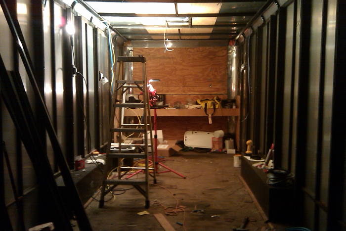

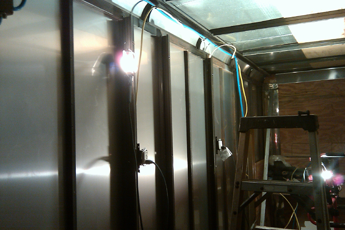

In this pic, you can see the aluminum stand-offs on the wall and the ceiling. The ceiling ends up 2-1/2" thick, and the wall ends up 4" thick. The nice thing about the wall being 4", and why I planned it so thick, is the inside floor width will be exactly 8' wide between the aluminum. Nice for putting in the extra floor plywood :thumbsup:
If you look close, you might see some wires hanging from the ceiling, some of that is the wiring for the lights, and one pair is the Fantastic Fan I have yet to wire in. It really hurts that the WFCO isn't in it's final position...

Postby Wolfscout » Mon Aug 15, 2011 3:51 am
I like that you are giving yourself 4" walls. more insulation inside will help on extreme hot or cold days. plus you can hide the 110 boxes better,.
great Start.

12 seems like alot, the original plan was 8. 3 on each wall, and 2 in the kitchen. Then I changed the layout a little, and added a bathroom-closet-kind-of-thing. Now there's one more in the "bathroom", and 3 on the outside. I hadn't planned on exterior outlets, but a friend with an RV talked me into it. I know I've used his exterior outlets on many occasions, so it seems like a good thing to do.
As far as the wire, all of the wire is secured using vinyl coated steel clamps at every place I can. Anywhere it crosses a stud, I plan to wrap it in the bubble foil style of insulation. All of the sharp edges that I've installed will be covered by the 2" insulation.
