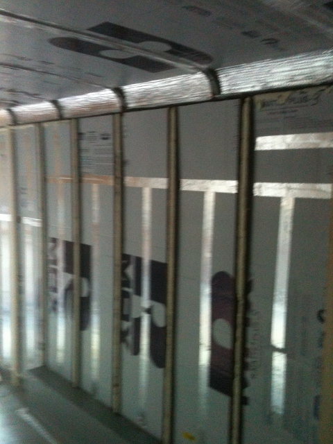

Postby lmajeff1 » Sun Mar 25, 2012 9:29 am
Good Morning,
Well the work (which I am actually enjoying) is continuing. I am almost done with the second layer of insulation in the roof. Then I will add 1/2 X 3 inch strips to the roof sparrs to insulate the trailer from the heat they generate. I am a firm believer that the sparrs if not insulated would be the same as is opening the back ramp on my trailer in the dead of summer. I have started removing the panels from the right side wall of the trailer and was pleased with seeing that when WELLS CARGO builds a trailer that it is done well. :) The trailer is 7 years old and only had surface rust on the framing structure in the walls. I was pleased to see that the vertical structure was welded on both sides top and bottom. They say that the AUTOWAGON is built to be on the road for 20 years or more. I remove the glue that was used along with screws and scruffed up the rust and painted with Rusty Metal Primer. The next stage will to be installing 1/2 inch thick insulation between the wall structure. It seems to be going slow but working 60 plus hours a week does not leave much time for the trailer. I hope that you enjoy the photos. :FNP

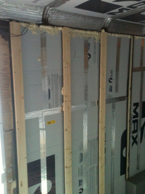

Postby lmajeff1 » Sun Apr 08, 2012 6:57 pm
Well got some more work done on the trailer this weekend. I am ready to install the interior wall on the passenger side of the trailer. It is hard to put in to works the sound the uninsulated wall with out the 1X3 Inch furring strips makes and the sound and feel of the wall makes when it is insulated with foam board between the vertical and expanding foam in the channel of the vertical spar. I hope to start installing the wall this week. Have to have it all done by 1 July as we will be going camping in it that following week. :D

Postby 8ball_99 » Mon Apr 09, 2012 12:14 am
Looking good. Your insulating yours a lot like I did mine. I didn't do the wood strips on the walls though. I just put the 3/8" plywood back on and covered that with some luan. The strips probably cut down on the weight. Only thing to keep in mind most of the trailer places I talked to wouldn't leave off the inside plywood because they said it was part of the structure of the trailer. Not sure how much it really matters. I'm sure you will have some kind of paneling or plywood on the walls so maybe thats enough.
LoL got to say. There was a lot of building my trailer that was fun to do.. The insulation wasn't to bad, But I was Very glad when I stuck that last piece in. With the foil, then the 3/4" foam then the furring strips and then the 1/2 foam between them :? I am glad I took the time to do it though cause the trailer holds its temp very well.
