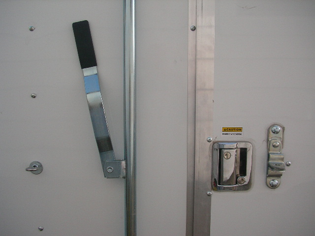

Does a factory side door come with RV type latches or do have to add/modify one to get that feature instead of the cam lock design?

I've got a trailer on order. My dealer normally orders both locks unless the customer wishes different.

Often the RV latch is an option, but it really depends on the manufacturer and also if the trailer is already on the dealers lot, it depends on what the dealer ordered. I've seen cam locks only, RV latches/locks only and others with a cam lock and an RV latch.

When I ordered mine I had them leave the cam lock and add the RV style lock. My though was it would be more secure. I now wished I had skipped the cam lock cause all that has done is get me locked in by one of my friends little boy. He latched the cam lock with me and the wife inside. He thought it was funny. The wife was not amused.
I need to come up with something that will prevent this. For the rest of that trip I tie wrapped the cam to the handle. At least he would have to cut the tie wrap before locking me in .. :thinking:

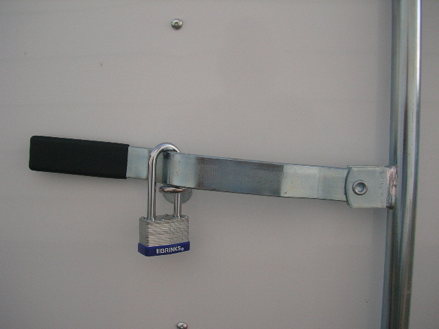

I saw someone with a solution. The door lock handle would be folded back against the trailer wall. There was an angle pice bolted to the wall that permitted locking the handle in the open position with the padlock that would be used to lock shut the door. Sorry no pictures.

I had seen that before on a trailer but the way that the handle is bent it wont lay flat if opened 180 degrees so it wouldnt work in a standard latch. I thought about drilling a hole in the handle and locking it around the bar but I havent found a lock that has a radius big enough to do this.

Drill your hole in the handle and use one of these.

Here's what I did, and others have done too. Just drill the hole, insert the eye bolt, secure nut on the inside, and lock it open! I drilled the hole through a stud for security and strength. When its time to leave it, close the cam lock, and use the same pad lock to lock it closed. Easy.

Postby Dirtclod » Fri Oct 11, 2013 2:58 pm
Gonefishin
YOU ARE A GENIOUS !!!!! :applause: :applause: :applause: :applause:
I will defintely copy that idea for sure.
THANK YOU THANK YOU THANK YOU THANK YOU :beer:
