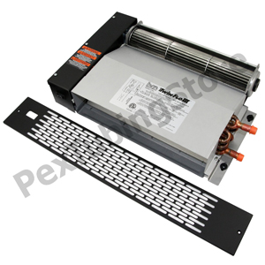

So I am now wondering, why could not this be done in a CT? Either by running the water through "fins" like in a home baseboard system or through a large heat exchanger like the ones used to put radiant water heat in your air handler (or even a radiator of sorts).

My plan is to do a similar thing. I am thinking along the lines of pumping the heated water through a finned assembly like an auto heater core or a auxiliary transmission oil cooler. Probably a tranny cooler as I have a couple NOS sitting in boxes on a shelf. Put it in a box/ducy and then use a small fan to circulate air through the core; there are some computer fans that are very quiet. Small 12 VDC pumps are available.
http://www.amazon.com/dp/B005EU7ONM/ref=wl_it_dp_o_pC_nS_ttl?_encoding=UTF8&colid=1AUD4PWVH507A&coliid=I2U32TJIBFFBFH
If you click on the image in that link that will bring up larger images with full pump specs. You can find lots of cheaper ones on ebay; direct from China. I may try one of them.
