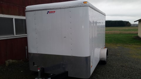

Pace America 7x12 Front view

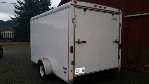

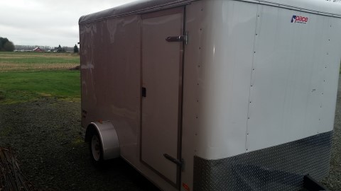

Pace America 7x12 Side view
Pace America 7x12 Rear view
