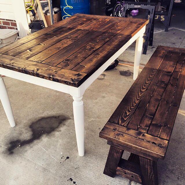

I hear ya man! I can understand that. I always worry about particle board and MDF getting moisture on it and molding or falling apart. I have the kreg jig set actually and build a lot of farm house tables. I thought about going that round and building a custom cabinet set with a farm house table top. Here is a picture of one of my recent tables.

Great looking table, and I see the nice saw in the background. So you are clearly well on your way to do it your way. Keep us posted on your progress.
