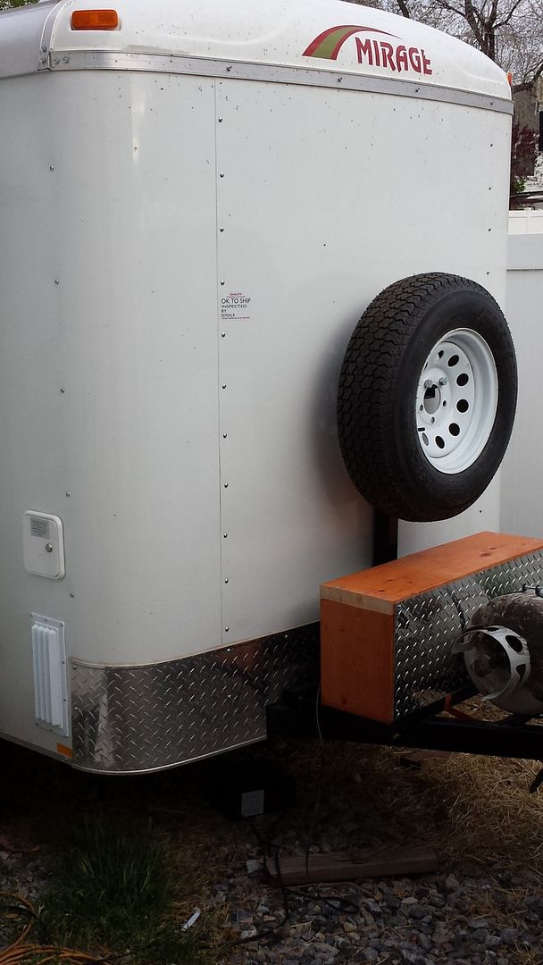

Postby desertrat222 » Mon Apr 27, 2015 11:04 am
Here's mine, hold 4 deep cycle bats.

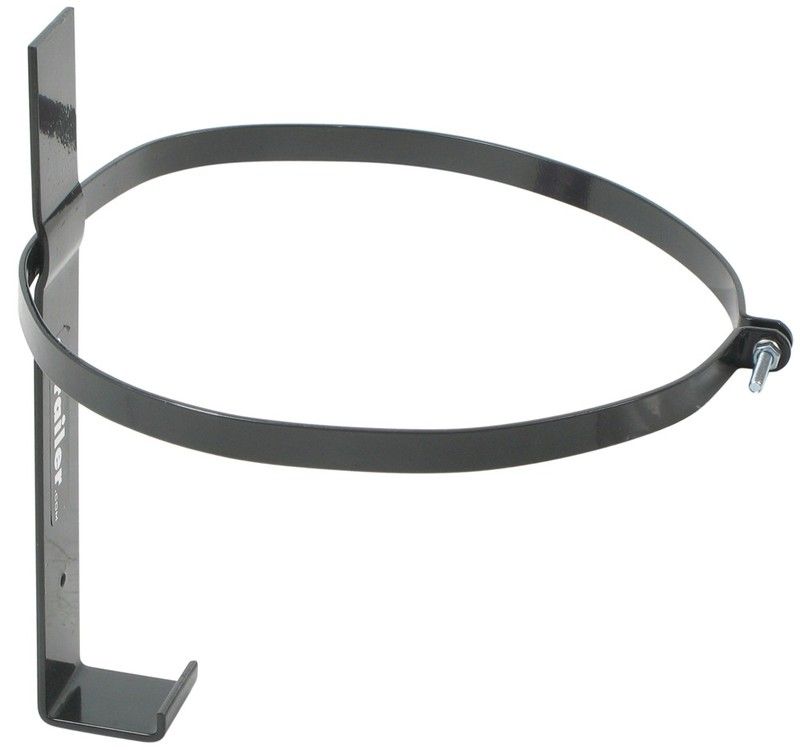

Postby desertrat222 » Mon Apr 27, 2015 11:08 am
i just welded one of these one. google single LP tank bracket.

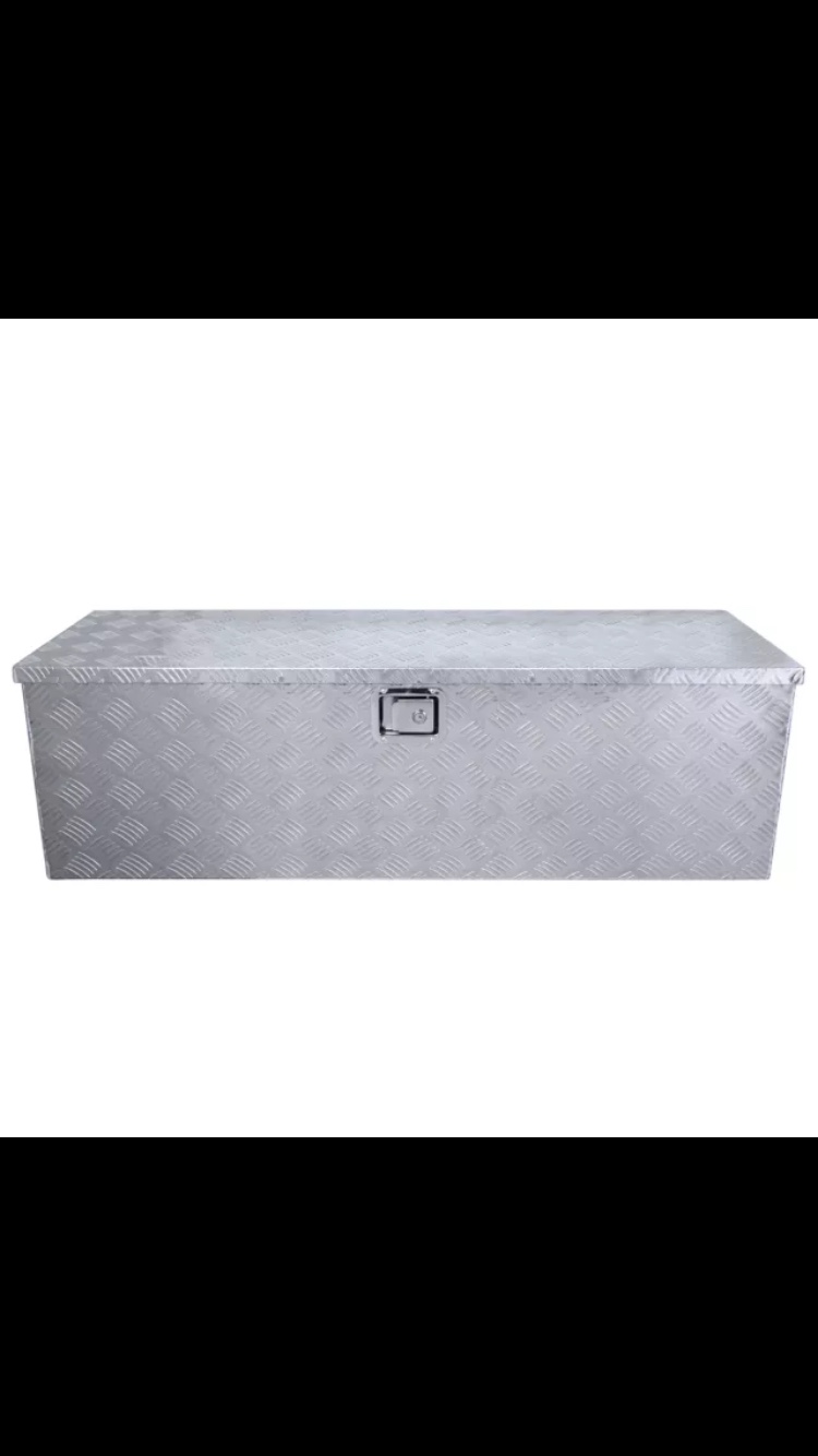

Postby gisclair615 » Wed May 06, 2015 1:56 am
Nice set ups here. I decided to go with an aluminum box. It should be delivered in a week. This is what I found . I hope it looks good on the tongue. It's 49" x 15" x 15". I will put my propane tank and battery in it. My idea was also extra storage being I'm only in a 6x12.
