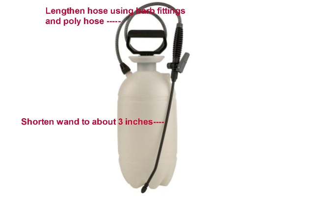

For hot water I heat it on either my heater, if it is cold in the mornings, or my cook stove if I don't have my heater stove on. Then I mix it to 110 degrees in a sprayer with a short wand (1 to 3 inches). Image

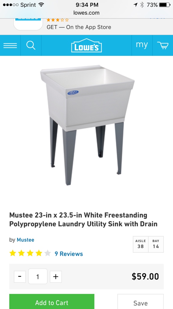

Ok so I went to lowes and bought one of these utility tubs. It's almost 24x24 which is plenty of room. I'm going to build a box around it and it already has a drain so I'll drill a hole and run a short PVC pipe to the ground so that I can just let it drain to the ground. (I'll use biodegradable products) then I'll use your method for hanging the shower curtains. The curtains will just lay on the in side wall of the tub so it should work well. Still trying to figure out what to use for a shower head or a tankless water heater

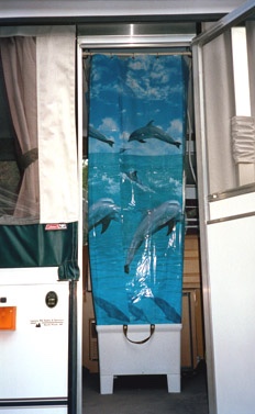

This is taken from google but where I got the idea from:

that's a good idea,look like it don't take up much room,but how is the shower curtain go around the whole base?
Jeepcamper
Posts: 11
Joined: Mon Nov 02, 2015 5:03 am
Portable/Permanent Shower Help
Postby Gunman9 » Fri Nov 06, 2015 9:06 pm
Jeepcamper wrote:that's a good idea,look like it don't take up much room,but how is the shower curtain go around the whole base?

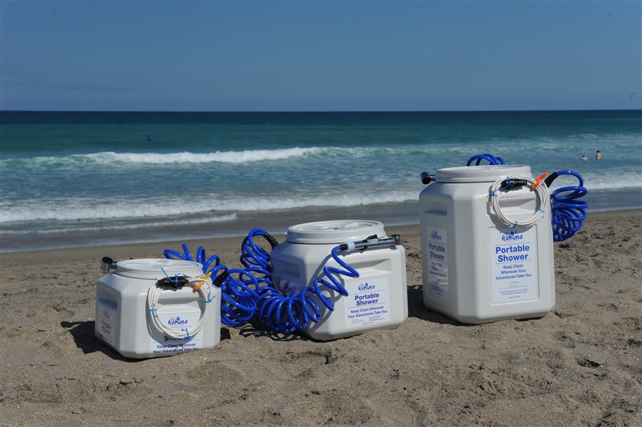

I'm going to use a square PVC rig to hold the shower curtain. Will take 2 shower curtain. When the shower is not in use it will be a bench. I'm building a bench around it with a 5" thick foam topper (its what I have laying around). I'm using a Big Kahuna portable shower as my shower pump and water supply. The 8 gallon tank which is the middle one in the picture. They come is 4.5 gallon, 8 gallon and13 gallon. There also made in America and come with a lifetime warranty and they sell heater pads to heat the water. It's a sweet rig.

"There also made in America and come with a lifetime warranty and they sell heater pads to heat the water. It's a sweet rig."
That is a sweet rig. Could you tell me your source? I can't seem to find the heater pad.
McDave
McDave
Posts: 2288
Images: 412
Location: Tiny Town, Montana
Postby Gunman9 » Sun Nov 08, 2015 8:24 pm
Ya it's called the Wolverine 500. It's sold on Amazon. I emailed the company and the owner said that is what they use and recommend. They have one in development for the big kahuna but they said it will be longer than expected before it is released
