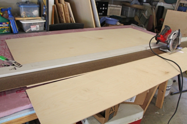

Finished cutting all the wall panels yesterday and dry fitted them.
The boards cut in a horizontal pattern in the front will be hidden behind cabinets. I just made the best use of scrap pieces.
They have been removed and staining will start today.
Also I hope today to go buy the prepainted ceiling panels and more ceiling insulation today if the rain stops.

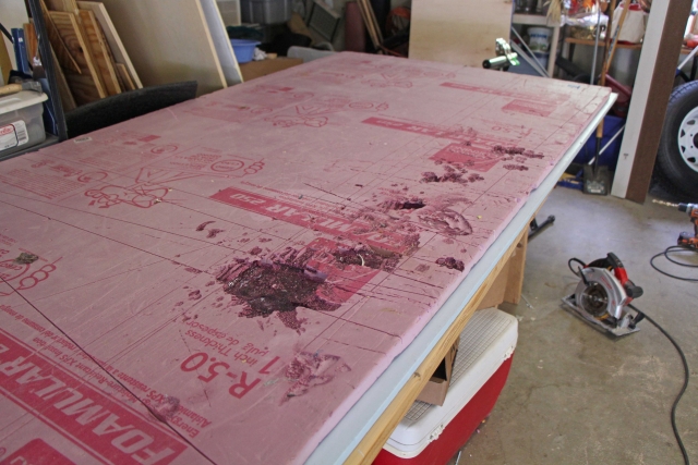

This panel cutting template makes cutting both a breeze and very accurate.
I knew better, but I showed myself again that you cannot spill Acetone on EPS boards.

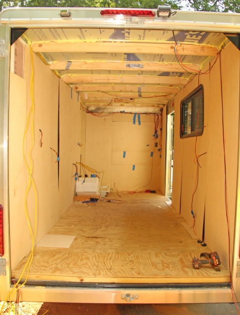

Postby lrrowe » Thu Jul 02, 2015 7:31 pm

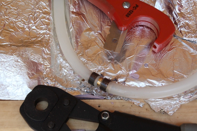

MISTAKE!
I was finishing screwing down the top of my subfloor. And you know how as soon as you do something bad, you try to stop and it is too late? I screwed right into the PEX tubing I had installed in the subfloor. I was able to repair it, but now the water flow is reduced just a tad because of the smaller diameter of the connector.
Also do you know when it is time to stop work? When you find yourself making serious mistakes.
STAINING:
My wife Lynn is helping to stain the sides of our trailer walls.

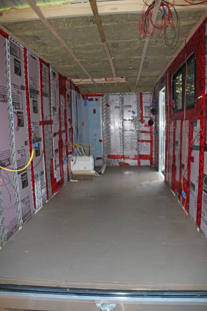

INSULATION AND FLOOR STAINING:
Got a lot done with the ceiling insulation. 1/2 in insulation board goes over what you see here.
Also stained the floor with Dock floor stain from Sherman Williams. Allure Vinyl Strips will go on after the walls and ceiling panels are up.

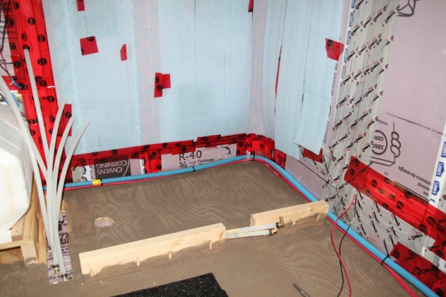

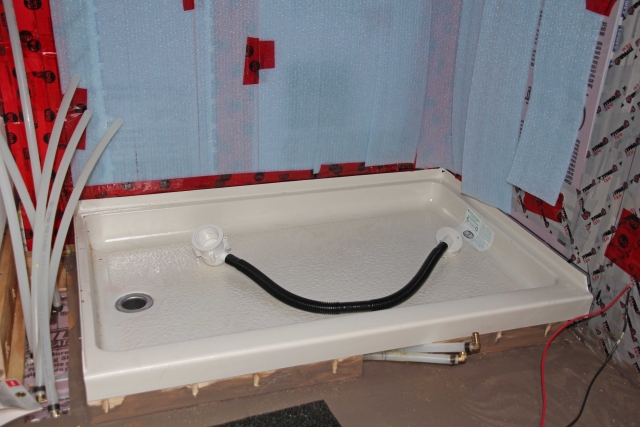

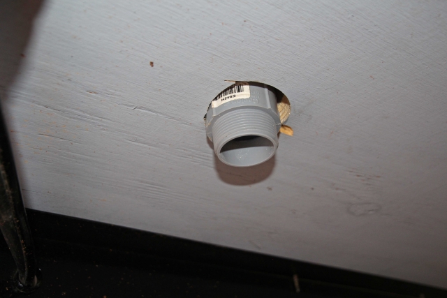

SHOWER PAN:
Before the shower pan is secured, wiring is wrapped around the back of it.
The drain and extension were added and shower pan positioned in place. The drain system is shown in the pan.

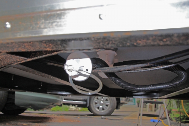

The shower drain extension and drain plug/tube shown. I will use a garden hose to drain shower water to 5 gal bucket. If sink is added later, it will run into this setup with a "Y" added.

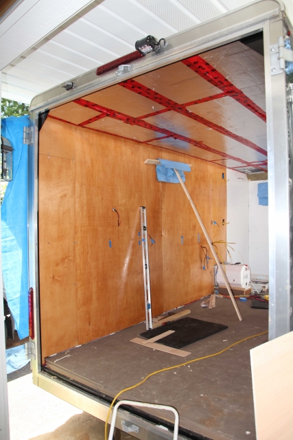

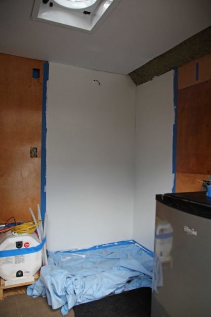

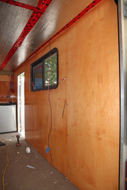

Postby lrrowe » Tue Jul 14, 2015 8:07 pm
This coming Thursday I venture out on my first real camping outing (not including my hunting trip last year) with the CT and it is not really ready. But I paid for the nights many months ago so I could go along with the Old Dominion Chapter of TearJerkers for a few days at the Creeper Trail in Southwest VA. My wife and I are anxious to meet other TnTTT'rs out there so regardless of the readiness of the trailer, we are going.
I just wired one outlet so we have a refrigerator working and my wife is happy about her coffee pot. I have not gotten her into the wilderness aspect of cooking without electricity yet. Other then that, the trailer is in essence just a tent with hard sides and top.
I hurried as fast as I can to get to the state these photos shown, struggling with an ailing back.

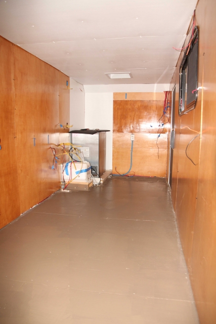

The interior panels are all up and final ceiling insulation installed.
The ceiling is up and floor recoated with a sealer (before Allure Vinyl Panels are installed later)
And you know it is time to quit when you sort of paint yourself into a corner so to speak. See how I temporary located the refrigerator in the shower pan while painting the floor. But I forgot to plug it back into the outlet. Now I have to wait til the paint dries. And it does not do that quickly when you watch it.
The Shower Panels got their final coat.

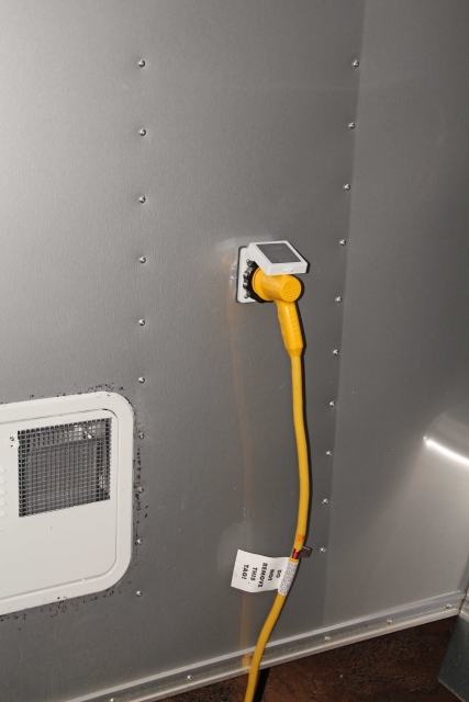

The Marinco 30 Amp inlet installed. But only temporarily as the PD4045 is not yet installed. This powers only one outlet for the refrigerator.
And yes, I have some clean up to do with the sealer around the heater cover.
Bob
