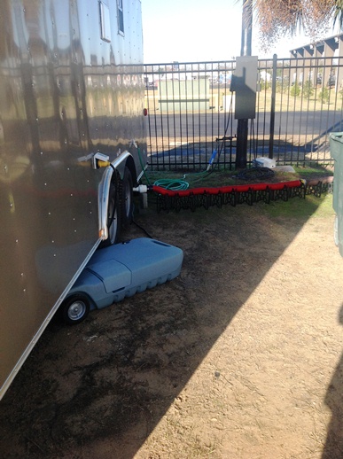

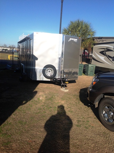

Postby Wolfscout » Thu Jan 19, 2017 6:24 am
We camped at the State Fair Grounds the other week. My wife works for the company that was holding a distribution vender show.
I got to test a lot of the things I've added on.

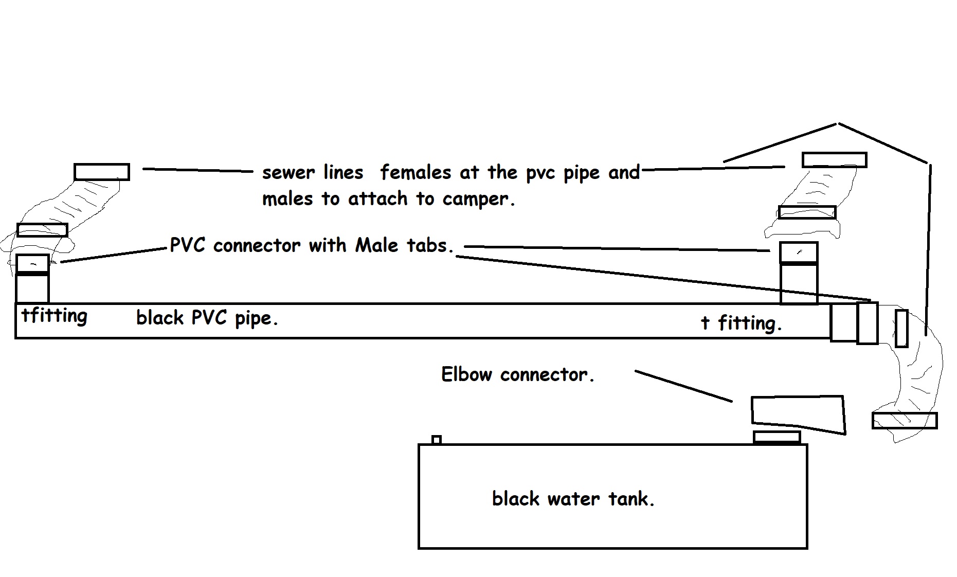

I have been racking my brain trying to figure out how to plumb my sink and shower together to a waste gate then drain to a portable holding tank. Could you share some pics and list parts for your exit plumbing/adapter. Thanks!
This is how Jerry did his shower and sink gray water plumbing on his Retro-Kamper: http://www.tnttt.com/viewtopic.php?p=1067912#p1067912.
Sorry this is late. I've been absent for a good while.
Hope my BS Paint skill can give you an idea.
sewer pipe modification..jpg (187.95 KiB) Viewed 3874 times
