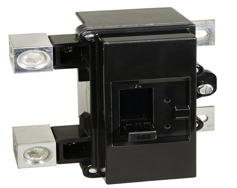

Tommy, got good news and bad news. If your panel is like mine, you can add another main 150A breaker inside and in series with outside main (that's the good news). The reason they started putting the main shutoff outside in its own sub panel (I believe) was for Fire and Rescue so they could quickly disconnect without going in. The panel knockout comes out and a new 150A breaker goes in and then you can use the interlock with a 2 pole breaker at the top. It is minimal rewiring if you are already using that position. Bad news is the breaker is about $125.00, but with interlocks and etc., we could do the whole job for around $225. It will be code and safe. I can help you do it. I think I will do mine also so I am code compliant for whole house as well as my small gen transfer switch. edit....not bad news anymore.. just got the breaker on Amazon for $67.00 and I ordered the interlock... both for $119. All you 'd then need is your connector box . Probably all less than $200.00 Note. the interlock kit will take 4 to 6 weeks to come in according to Amazon. We should just plan a Saturday and do yours when they come in. Just make sure your panel is Square D / Homeline or QO and looks like mine. It should work.
https://www.amazon.com/gp/product/B0068 ... UTF8&psc=1
https://www.amazon.com/gp/product/B00CO ... UTF8&psc=1
The new breaker will bolt down down and incoming wires will go in the breaker's terminals in the same fashion. Litterally a 10 minute job.
This is my panel. You can see the knockout for the inside master breaker. I need to move the red gen breaker wires to the top and the 2 pole breaker at the top's wires down to bottom and then install the mechanical interlock previously shown.. and we call it done. You can see the lockout I have on my gen breaker so no one turns it on either way on accident. I just have to make sure to go outside and disconnect main and put the lock on it before before that is flipped. It is manual and not exactly code since it is possible to have both on at same time if you don't know what you are doing. The interlock prevents that.
The new breaker will just bolt in and be in series with outside breaker so that is actually good for the Fire Rescue folks if ever needed and double protected.

Postby Tommy B » Fri Sep 22, 2017 7:13 am
Wow I almost posted the same thing yesterday but ran out of time. I was looking at the 200 amp version as I did not know any better. 150 amp is even cheaper.
I will still have to order the cord. Whether its 50 or 100 feet, 8 4 or 10 4. another 150-200 bucks there.
That's a long wait for the interlock kit but I could utilize the set up in an emergency by throwing the main outside in the mean time.
No transfer switch for me. Just cant afford it. Let you know when it all comes in. It will take some time for me to run the cord. Not sure exactly how I want to run it. See you tomorrow 9-noonish. Still much debris to clean up.

Postby Tommy B » Fri Sep 22, 2017 7:37 am
Square D by Schneider Electric QOM2150VH QO 150-Amp QOM2 Frame Size Main Circuit Breaker for QO and Homeline Load Centers
$67.00
This one right?
Amazon.
Tommy B
Posts: 891
Joined: Sun May 08, 2016 4:37 am
Re: HALLMARK 6X12 CONVERSION
Postby flboy » Fri Sep 22, 2017 7:48 am
Tommy B wrote:Square D by Schneider Electric QOM2150VH QO 150-Amp QOM2 Frame Size Main Circuit Breaker for QO and Homeline Load Centers
$67.00
This one right?
Amazon.
Yes, assuming your Panel is the SquareD OD or Homline type. Did you look to see if yours is or at least looks like mine inside?
