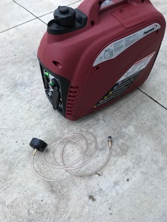

Postby featherliteCT1 » Wed Jan 10, 2018 4:12 pm
180110 Powermate Cap line.jpg (31.63 KiB) Viewed 4518 times
A few months ago, I purchased this Powermate 2000i generator from Walmart for $488. I tried to rig up an auxiliary fuel tank like flboy did with his Honda 2000 generator but I failed. Evidently, the Powermate (and the Yamaha equivalent) do not have fuel pumps like the Honda.
In order to add an auxiliary tank, I would have to raise the auxiliary tank to an elevation higher than the generator to induce gravity feed. I do not like that idea.
I did not want to risk destroying my original gas cap on the generator so I searched the local stores for a spare gas cap. The Yamaha gas cap is the only cap I could find that fit my Powermate generator. However, the Yamaha cap sells for about $38. After a long internet search, I was able to find a gas cap for the Powermate generator for $8 plus $8 shipping. I then spent about $20 for fittings and sealants.
However, the Powermate could not suck the gas from my auxiliary tank.
I now know that parts for the Powermate are a bit hard to find and that neither the Powermate nor the Yamaha generator has a fuel pump. However, the Yamaha has a fuel gauge but, to my knowledge, the Honda does not. A fuel gauge would be handy.
I am not sure if I will pay $1,000 for a Honda ... but I am sorely tempted.

Postby McDave » Wed Jan 10, 2018 8:40 pm
Something funny going on there. You should be able to get siphon going even without a pump. Either an air leak or a no vent condition. Aux. tank should be vented but no vent at main tank. As motor uses fuel instead of air replacing fuel, fuel from aux tank should replace into main tank and air into aux tank.

Postby flboy » Thu Jan 11, 2018 8:29 pm
McDave wrote:Something funny going on there. You should be able to get siphon going even without a pump. Either an air leak or a no vent condition. Aux. tank should be vented but no vent at main tank. As motor uses fuel instead of air replacing fuel, fuel from aux tank should replace into main tank and air into aux tank.
McDave
I agree. I wasn't aware my Honda had a fuel pump.I just always assumed it was the siphon effect. It does have to be an airtight connection or it will not work. Also, the draw tube need to be in the bottom of the auxiliary tank. I boat motor tank will come like that.
I used Teflon tape on all the connections. The fitting you have in the gas cap... how is that installed. The seal there on the tank and on the hose is critical and the auxilary tank must be vented as already said.

Postby featherliteCT1 » Fri Jan 12, 2018 9:03 am
McDave
Thanks for the reply.
I too was surprised that the generator could not suck gas from the auxiliary tank.
I made sure that there was no leak by using gas resistant thread sealant plus a gas resistant product called "Seal All". I bench tested the seal by holding my hand over the gas cap, with the tube attached and blowing into the tube ... no leaks.
I then completely filled the generator with gas up to the lip until the gas almost overflowed and the generator ran for a short while before it quit. I also made sure that the intake end of the plastic tube was completely submerged below the surface of the gas. The generator was able to suck gas up the tube for only about three inches.
With an almost full tank, I also ran the generator with the original cap but with the vent closed .. and the generator ran for about 15 minutes before it quit.

Postby featherliteCT1 » Fri Jan 12, 2018 9:10 am
Flboy,
My "auxiliary tank" was an open quart glass jar with no lid. The tube hung deep into the gasoline. Consequently, I know I had no leaks and I had sufficient "venting".
I cannot imagine why the generator would not suck gas more than a few inches up the tube except that the generator itself could not create enough suction for the entire height of the lift.

Postby hankaye » Fri Jan 12, 2018 10:04 am
featherliteCT1, Howdy;
Having to supplement my fuel tank on occasion way back in the past, I found that
the connecting hose from source to target container needs to be full of liquid and
any amount of air in the tube/hose will stop the flow ... that said are you ensuring
that the tube/hose is full of liquid ???
