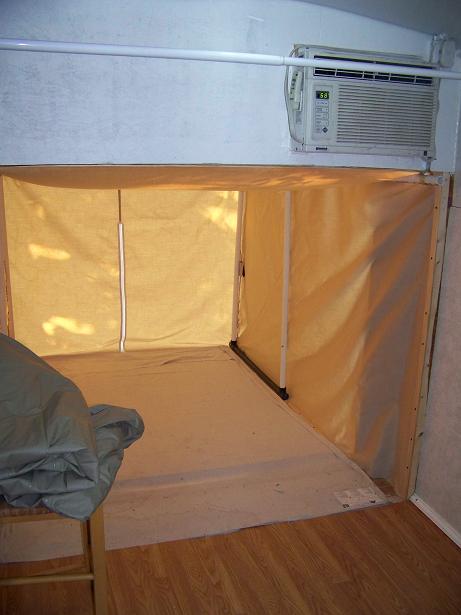

So your "bedroom" is permanently attached? Please show us how!
Yes, the "bedroom" is permanently attached! The rear door is held up by guy wires that fold inside with the canvas. I thought about using support legs on the outside of the door but figured it would be a pain getting it level. So the preset length of guy wire keeps the bed level as long as the trailer itself is level! I am taking it camping this weekend so I will snap some pics of it for ya!

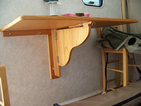

As far as the table, I got it from the kitchen of my house. I'm told that it came with the house when new (1957) so I have no idea where to get them! I'm sure that it wouldn't be hard to build!

here is a pic of the underside of that table..

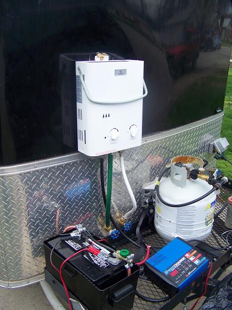

I would like more info on the Demand Hot water heater. How did you hook it up. Wheres the water coming in at? Wishbone,Ks

you can buy tables similar to that at IKEA.
http://www.ikea.com/ca/en/catalog/products/30062572

If you look to the right of the lp tank and under the electric hookup, you will see a "hose spicket" thats the main water in, as far as the rest of the hot water on demand, it has a splice from the main "cold" water line that goes to it, then the out is piped to the hot water valve at the sink and shower...

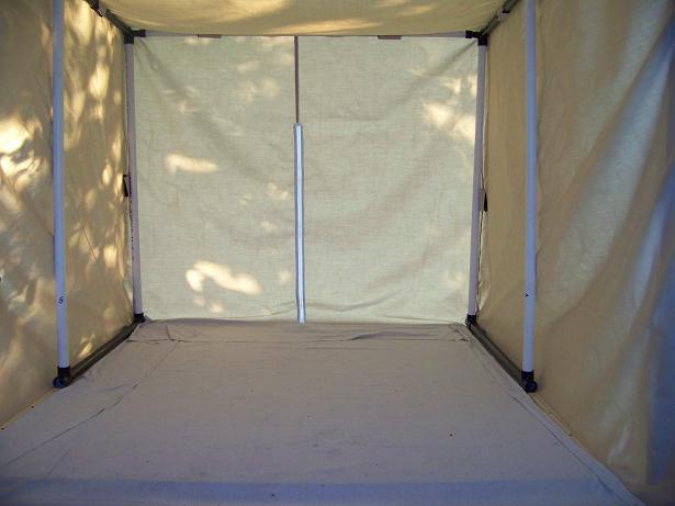

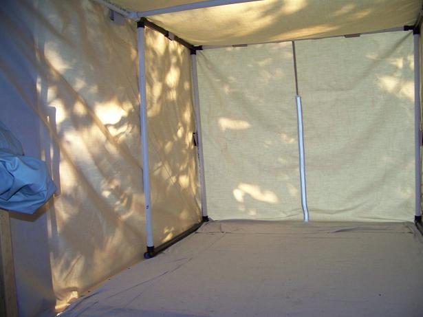

Some closer looks at the canvas...
