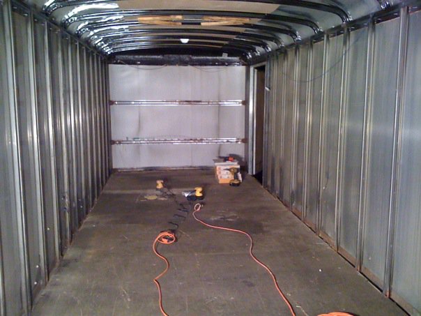

We've made a little bit of progress!!

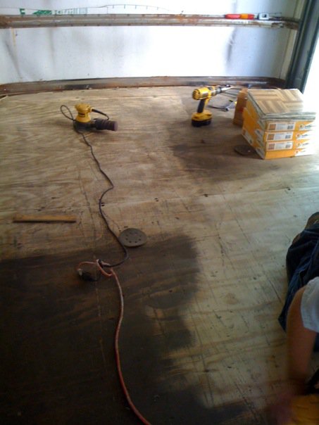

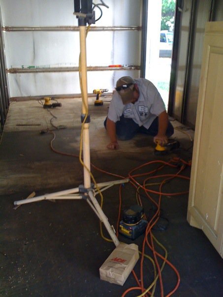

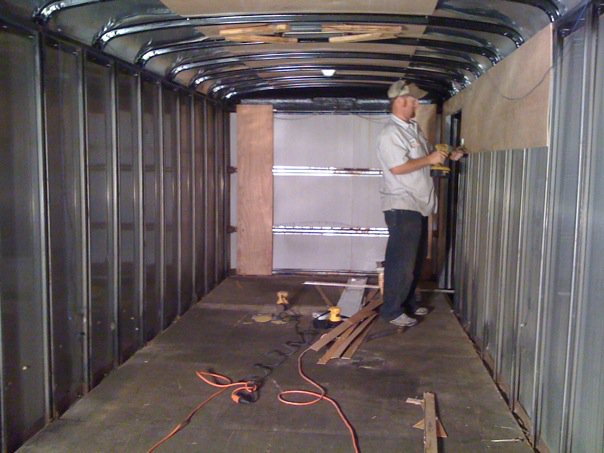

Thin factory plywood on the walls had to come down because not only was it torn up in several places, but it's also too thin, it would have become torn up quickly anyways.
Looks like a whole different trailer already!
The back section of plywood was torn up pretty good from previous owners. So we had to pull it up and put a new piece down. Note the color difference. That's how soiled the existing wood is!
Time to do some sanding!
Note the color difference again, after sanding a few patches:
We finished up the sanding today. We got a few parts ordered late last week, also. Main thing being the inner assembly for the a/c. Gonna get that installed as soon as it comes in. We also ordered some electrical stuff (I just smile and nod when David tells me all the electrical stuff), a window, and a door latch so we can get out. hahaha
A friend's father had purchased a ton of peel and stick tile flooring before he passed away. Our friend found it the other day in storage and gave us enough to do our floor for free!!

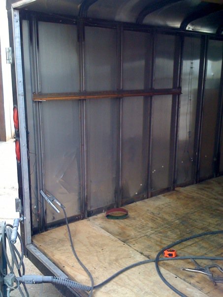

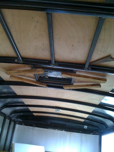

Tomorrow, David will weld another brace for the a/c (the other one is semi sufficient, but just a little bit of extra measure :) ) and do a few more things. Will post pics as they are done!
We're taking this baby out with a few air mattresses next weekend, so we have to get the a/c running, and flooring in this week! We're excited!

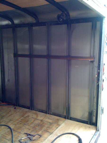

A little more progress today. Decided to give the a/c a little bit more support inside, because it was looking a little droopy from the outside:

Pretty cool!! So anyways, we got some brackets welded onto the walls today for that project, whenever we find some shocks.

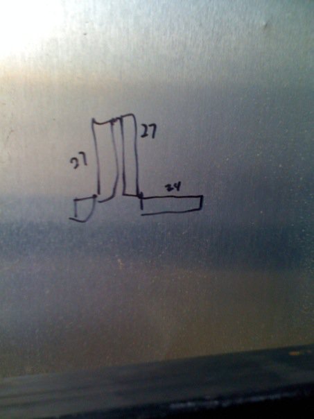

The bottom bunk will be about 8 inches off of the floor, and will fold up into 3 sections. Kind of hard to explain, so here's a diagram:
There are hinges at the end of each section, and legs at the end (not drawn). It will fold out flat for bed position, it is pictured in couch position, and it can fold up completely for travel.
Dave got the 3 frames built today, we just have to buy some hinges to put it all together, and then cut some plywood to screw to each frame, then I will have to break out the sewing machine and get some removable cushions made :)

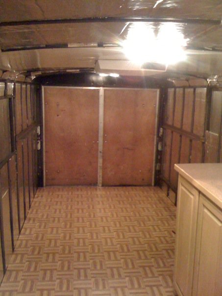

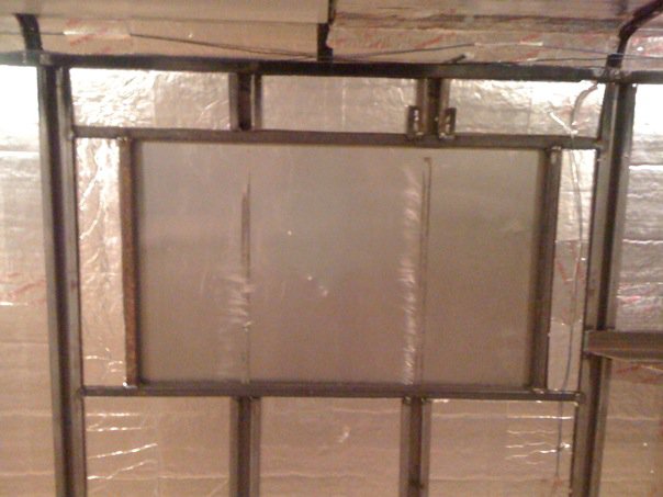

got ALMOST all the insulation up, except the front wall, and then the area for 2nd window. We have 1 window now, but still have to put it in, and will be ordering a 2nd window soon.
Got hinges to get the bottom bunk all hinged together, and got the shocks to get the top bunk going. We were going to get that stuff done tonight, but I think a girlfriend and I are going to take it out for a girls night out on the lake later. (even though it's already dark!)
Got 3 sets of double lights up and wired in. Holy moly...it's like daylight in the dark in there!!

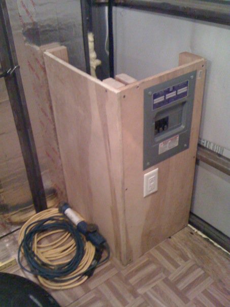

Dave got the electrical box built....this is what he says about it; "it's a 6 space, 12 circuit square D flush mount load center. One 30 amp breaker back fed as main; one 15 amp breaker for GFI; one 20 amp breaker for a/c. Will be landing another 15 amp breaker for converter soon. Load center enclosure houses 40 ft shore line, accessible from outside hatch."
Sooo....while I'm sure all of you know what all that means, I know what it looks like, and how to plug the sucker in. hehe
Here it is:

And the window frame:
