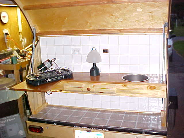

I made the flip out cabinets with 1/2" osb and covered it with a halo of luan veneer around an insert of 4" tile. I layed the tile out in a manner where nothing had to be cut and framed the area with the luan halo. I used brite white rubberized bathroom caulk to set the tile in and to grout it with. About 4000 miles and all are where I put them. Has worked out better than I planned and hot pans and propane cooktops are no worry at all.
