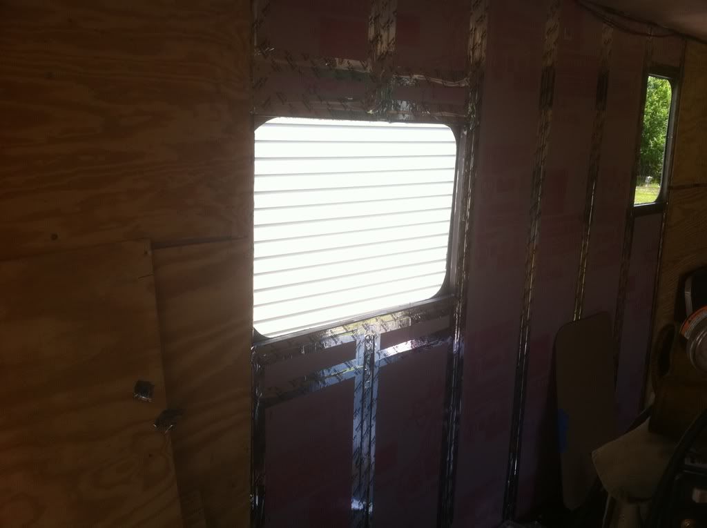

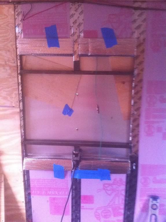

IMO, I'd also say you need to frame the holes for the windows. I've seen a bunch of threads on here where guys cut the metal wall studs and just frame the hole back with some wood. Its just not a good idea. One you weaken the wall but also one of the best things about a cargo trailer camper is the fact the wall studs are metal. Around a window or door is about the worst place in the world to replace the metal structure with wood.
Here is a couple pictures of how I installed mine. I also had to cut my studs for the windows to fit. My studs are 16" OC

Thanks for the info and photos! What I had planned was to use some metal angle for the frame bracing but with wood attached just for stiffener. I had also thought if I did it that way maybe I can have a little more room to play with since the wood can be easily trimmed. But now that I see what you've done I'll see if I can get some square tubing locally and do a more professional looking install like yours. Thanks for the help. :thumbsup:

Just have a look in your yellow pages. 1" square tubing is Very common. Almost any welding shop or steel supply place will have it in stock and in several different gauges. 16gauge is all you need. Its around 26 bucks for a 20' Piece. I removed some screws from the skin of the trailer and put some scrap plywood between the studs and siding while I welded the brack in. Just to make sure I didn't hurt the skin or the paint.

Thanks for the tip on undoing the metal. I had planned to do that so the sheeting on the outside didn't get burned but the plywood is a good idea and it looks like that's what pictured above by 8ball_99's post. Good stuff!

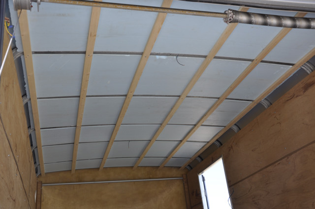

I was able to get the ceiling started yesterday. I installed the 1 1/2" blueboard and lathe. What I'm going to do is put 3/4" blueboard in between the lathe for a total of 2 1/4" of insulation. We love to winter camp and believe we need all we can get. I still have at least 2-3" of clearance (I'm 6') so I'll still be able to walk around without a problem.
Here's a photo of what this all looks like (before the 3/4" blueboard):
I'll be camping in it for 4 days starting tonight so I won't back on this site until I return. I'll give you a full report! ;)
