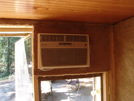

Postby jwhite » Thu Oct 06, 2011 11:41 am
I originally bought a 12000 btu portable and what a waste of money,I recently bought a 8000 btu window unit at lowes that was 30% off so for 150.00 I have a AC that will now freeze the trailer in less than a hour.
I haven't had the chance to try it in the summer yet but I think I have what I need now.
I built my rear wall on wheels to open and close, and with the AC as high as I could get it it blows the cold air down from the top where the portable you had to be sitting right in front of it to get any cooling.?
I bought a small ceramic heater at walmart cheap and it works fine for me,also I don't like cold weather so I won't use it that much,but I have to have a really good working AC.
