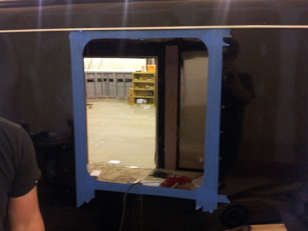

Postby kyfly » Sat Apr 28, 2012 12:12 am
I think its 6'5 if I recall correctly. Would definitely fit if I aired down a little. I'll be cutting a 30x30 hole for the window tomorrow...wish me luck all.

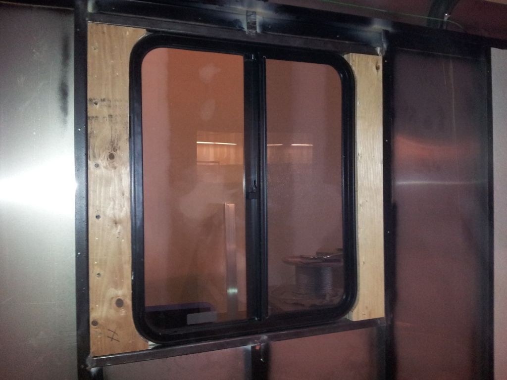

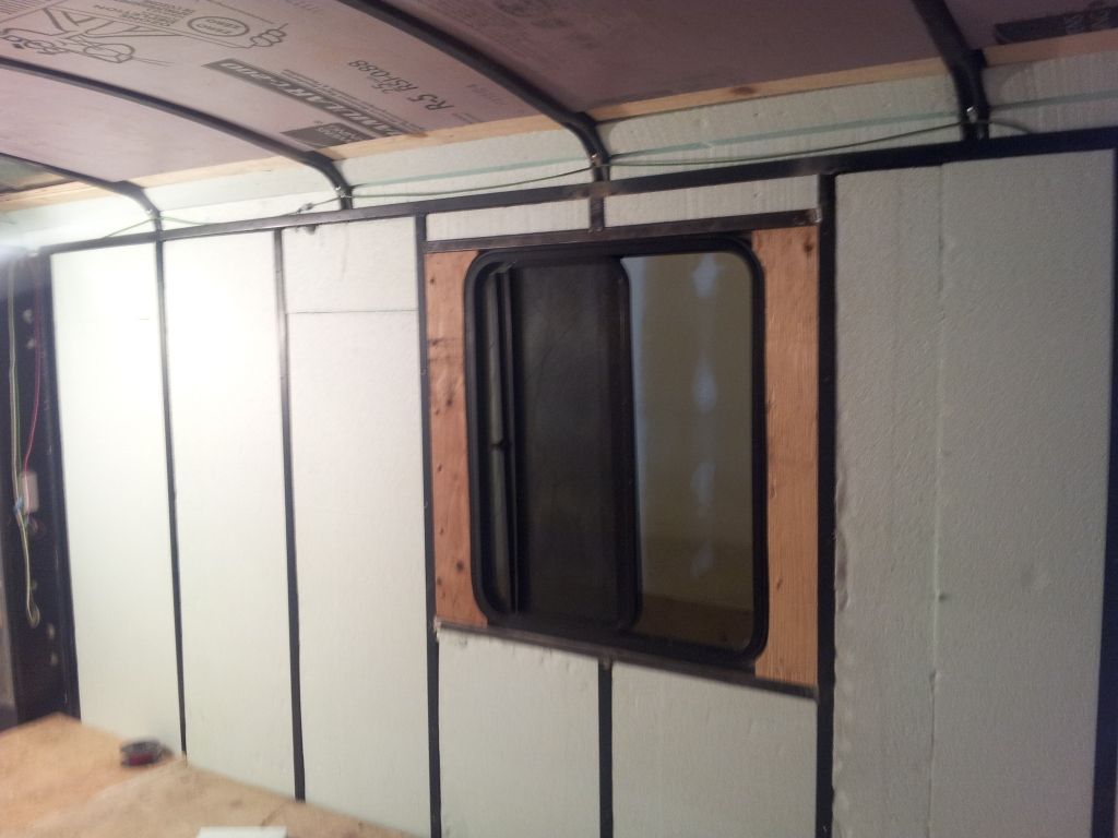

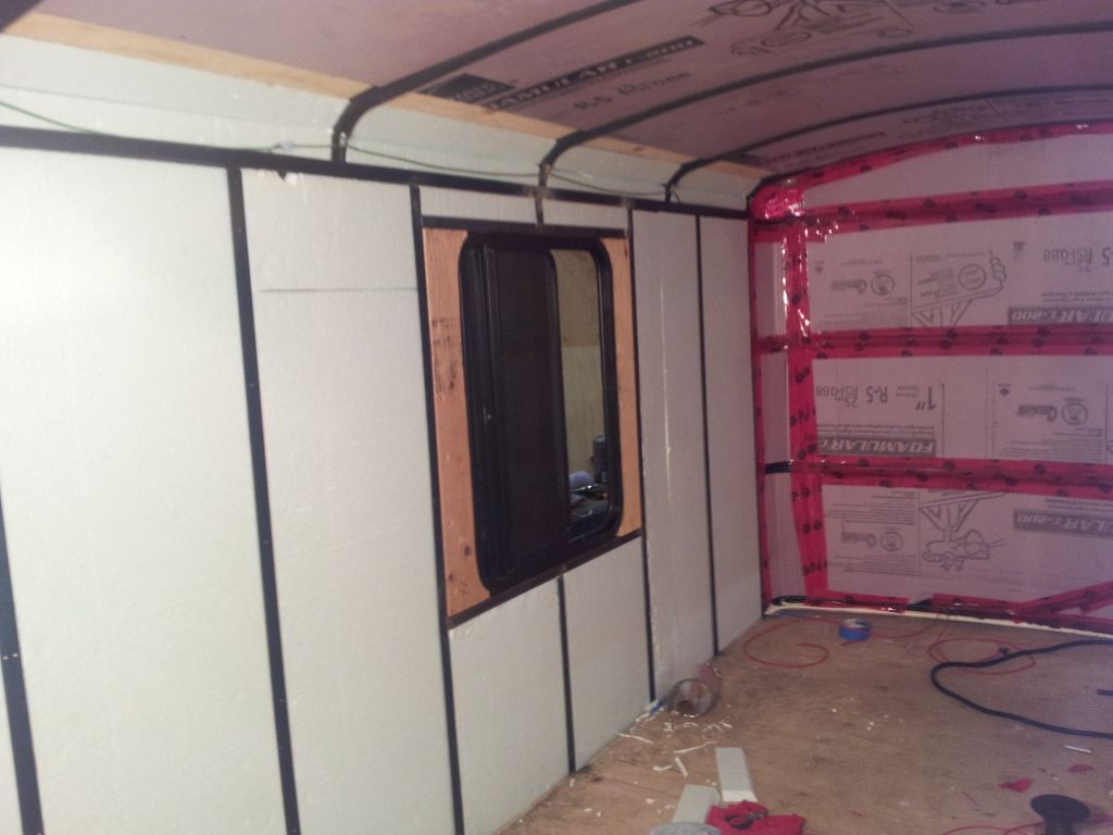

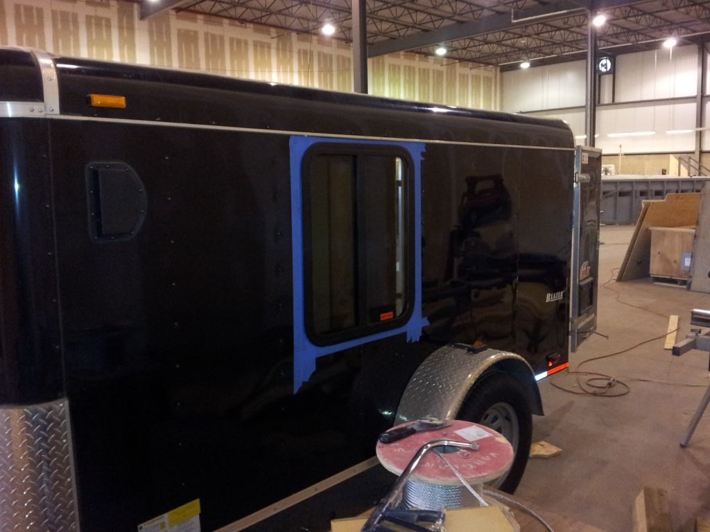

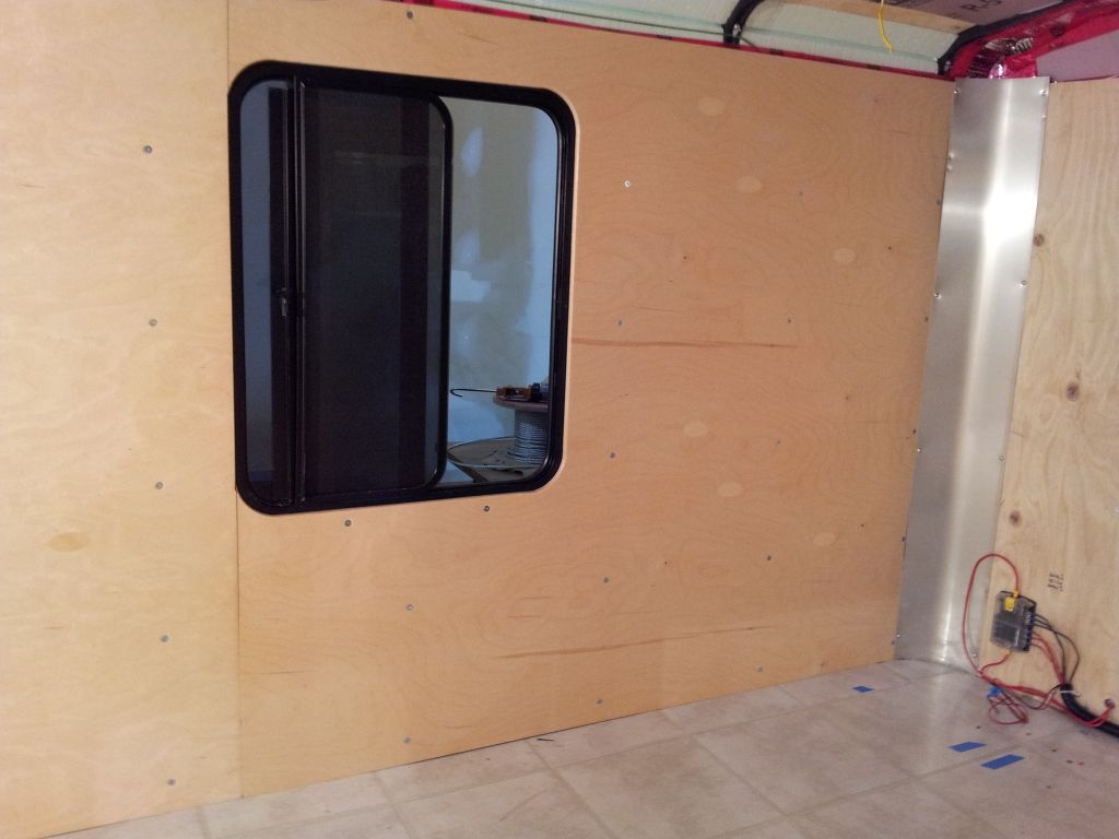

Postby kyfly » Sun Apr 29, 2012 2:02 am
Got started on the window install today. The hole is cut and I installed a 1x1 below The window as well as a 1x1 header. Then cut some 1" wood to frame in the sides. I drilled out the the windows exterior flange and it will be screwed into the steel top and bottom as well as the wood frame on the sides. The window is quite large compared to the trailer but its much brighter inside and I'm happy with The turnout. I have an 18x 24 being shipped and it will be installed on the opposite side. Pics to follow tomorrow.

Postby elmo_4_vt » Sun Apr 29, 2012 9:52 pm
NICE!! I like it. You can't have too big of windows in my opinion. I'd rather be able to look out and see what going on when I'm inside.

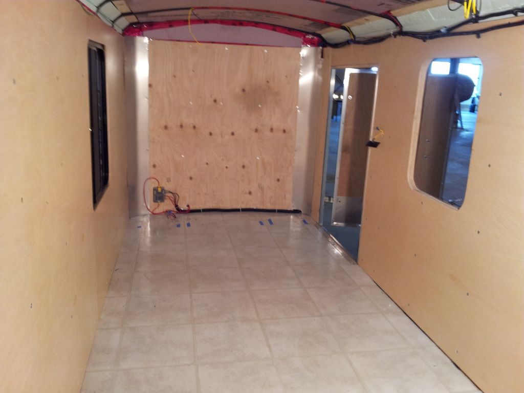

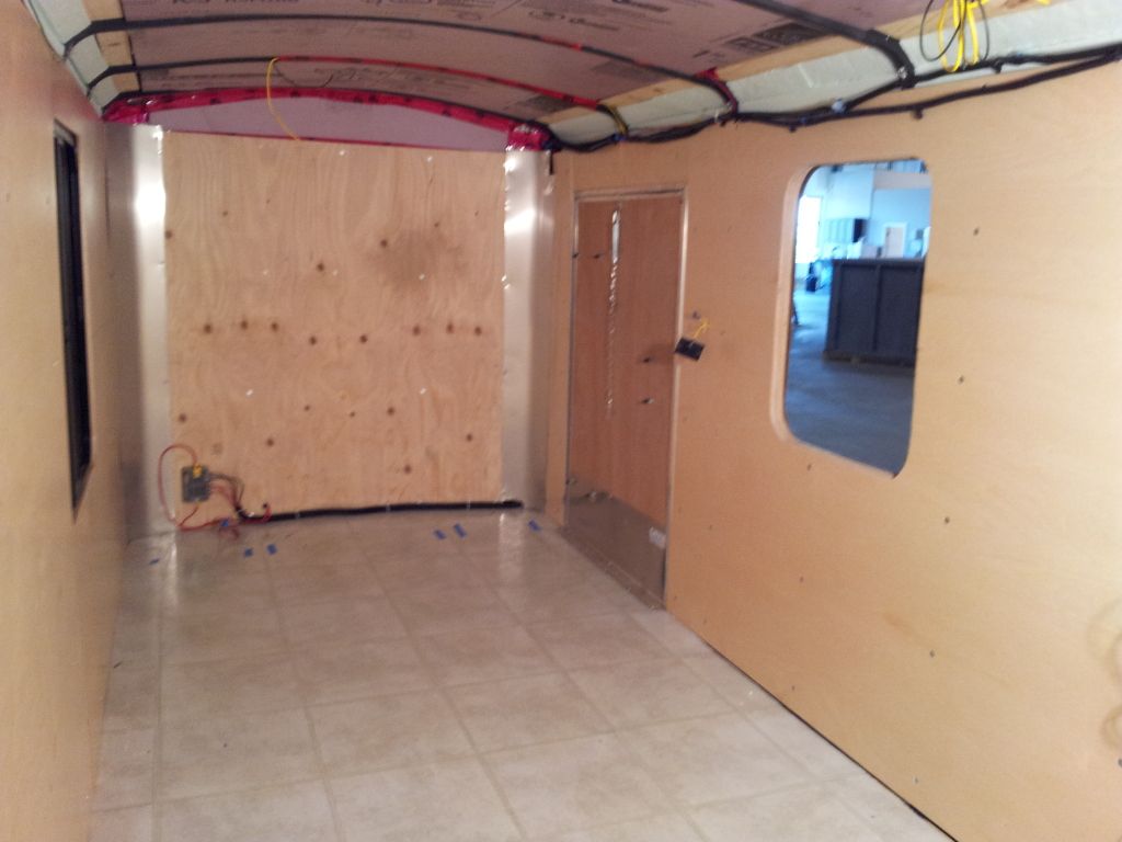

Postby kyfly » Tue May 01, 2012 9:26 pm
Its starting to look like something!

Postby Martiangod » Wed May 02, 2012 6:03 pm
Window is the perfect size, Love lots of window, tiny windows suck if your stuck inside due to bad weather
Trailer is a great size for your TV, any taller would be a major pita on gas milage

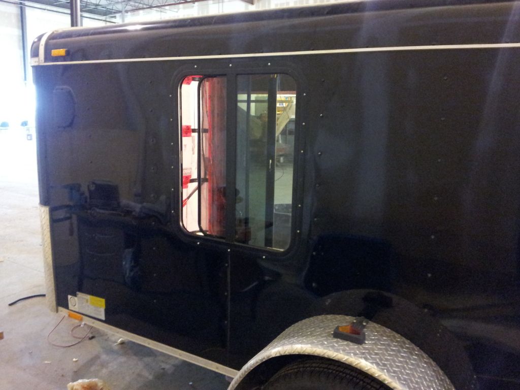

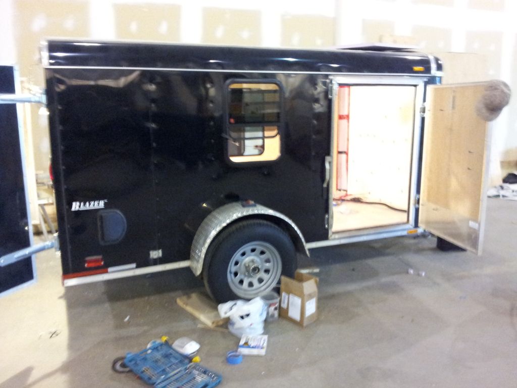

Postby kyfly » Sun May 13, 2012 9:26 pm
I feel quite lucky to find the trailer i did especially for the price i paid. I had been stalking the local classifieds for months before finding one. They just dont seem to make many trailers this small with a side door. i called around to a few dealers and got quoted 3000+ for a 5x8 v nose with a side door installed.
Progress has been a bit slower than id hoped but heres where im at now:
Im hoping to get the ceiling finished with white hardboard this week and get the last window put in. What screws do i need to use for the trim ring? Will any metal screws in the appropriate length work?
