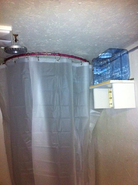

My sister and I have created the best shower situation for us.
We set up as vendors at various barrel races and most facilities have showers but not enough privacy or you have to wait in line.
We both have our cargo trailer rigged out to live in while at events.
Our showers or "redneck showers" as we refer to them
We mounted 3 cup hooks to the ceiling to hold a hoola hoop
We then hang our shower curtains on the hoola hoop
Sis stands in a #3 wash tub while I use a shallow heavy duty pan I purchased from Tractor Supply
We have shelves mounted on the walls just below the ceiling to hold a Water Container.
We both use the 2 1/2 gallon water containers with spigots that u can get at WalMart
We removed the spigot and replaced it with a kitchen sink spray nozzel
We heat our water in a coffee pot
With the water container up on the shelf gravity lets the water flow perfect. With the spray nozzel we do not have to reach out and turn water on and off, When we release the sprayer the water stops.
When finished we just pour the water outside.
Our showers work awesome for us and we can now shower in the privacy of our trailers

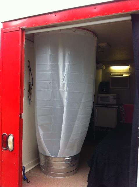

Our showers or "redneck showers" as we refer to them.
I probably spent more than lil sis did on her shower as a new #3 wash tub around here can be quite expensive....guessing here I probably spent close to $70 on the whole set up, cheap on everything but the wash tub. I didn't go used as I didn't want the possibility of leaks. When not in use, the curtains swing around and fit up against the wall and my tub slides under the bed. Needless to say I love it and we get loads of hahaha's and :thumbsup:
shower 2.jpg (34.51 KiB) Viewed 5211 times
#3 washtub, magnets on shower curtain help hold it in place.
