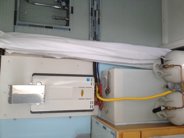

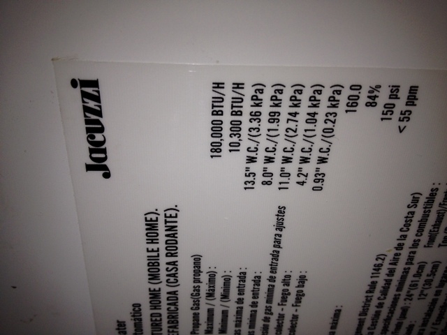

Postby OverTheTopCargoTrailer » Wed Mar 20, 2013 10:21 am
Hi Hankaye
No :D :D :D :D :D
180,000 Btu heater
It does not yet take a separate trailer for the propane 8) 8) ,
2 tanks make about 1600 gallons of hot water
photo 2.JPG (93.98 KiB) Viewed 2356 times
photo 1.JPG (85.82 KiB) Viewed 2356 times
on the bottom I have a valve to heat the water tanks- which in turn
will heat the trailer for 2 days

Postby hankaye » Wed Mar 20, 2013 6:24 pm
OTTCT, Howdy;
My previous post was only to show that one gallon of propane was only capabile
of creating 'X' number of BTUs , as that is the maximum amount of energy contained
within that gallon. To create the larger number of BTU' then a larger amount of
propane must be utilized.
I notice that you created your own plumbing system for the propane. Interesting.
Is there a High flow cutoff in the event of a leak? and those tanks, are they designed
for horizontal usage or vertical ... there IS a difference.

Postby bdosborn » Wed Mar 20, 2013 8:20 pm
hankaye wrote: and those tanks, are they designed for horizontal usage or vertical ... there IS a difference.
Take another look at that picture and you'll see that Jerry is just a little photo challenged. :lol:
