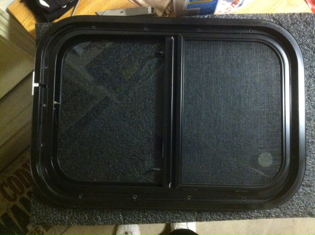

Postby speedracer170 » Mon Mar 25, 2013 10:35 pm
So I got my two kinro 15x22 inch windows today and now I'm lost. The trim rings look like they weren't bent correctly, looks like they don't screw into the window like I thought and only just grip a lip on the edge of the window. Anyone have any idea's cause now i'm having second thoughts about even installing windows.

speedracer170 wrote:So I got my two kinro 15x22 inch windows today and now I'm lost. The trim rings look like they weren't bent correctly, looks like they don't screw into the window like I thought and only just grip a lip on the edge of the window. Anyone have any idea's cause now i'm having second thoughts about even installing windows.
The interior trim rings that I have seen just screw into the interior wall. They are just cosmetic to cover the cut out. They are not really needed except to clean things up. I thought the same until I removed mine from my donor trailer. :DOH2:

Postby speedracer170 » Tue Mar 26, 2013 12:09 am

speedracer170 wrote:What do I screw the window to?
There is a small groove around the outside of the window frame that lines up with the holes in the trim ring, use small self tapping screws and that's it.

Postby roadinspector » Tue Mar 26, 2013 10:18 pm
Mine mounted different than pvangel. He is probably right on your style of window. I had to added cross-bracing to my CT frame to provide a solid support for the window and to have something to attach the window too. My windows screwed directly to the frame.
97881
Prem has a good thread on installing windows. http://www.tnttt.com/viewtopic.php?f=42&t=32504 You might want to check it out. It sure helped me. :thumbsup:
This is typical of this type of window. It is used in probably 90 percent of the rv industry, It is called a 'clamp-ring' style. When you secure the screws to the window frame it clamps it in place.
The screws actually go into the grooves made into the exterior trim ring. The screws do not go into the wall at all and form a tight clamp of the two halves.

I put the screws and the installed 4 pop rivets in each window just didn't trust those short screws
