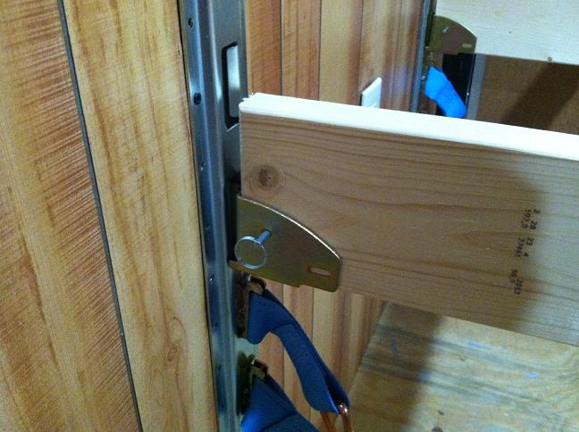

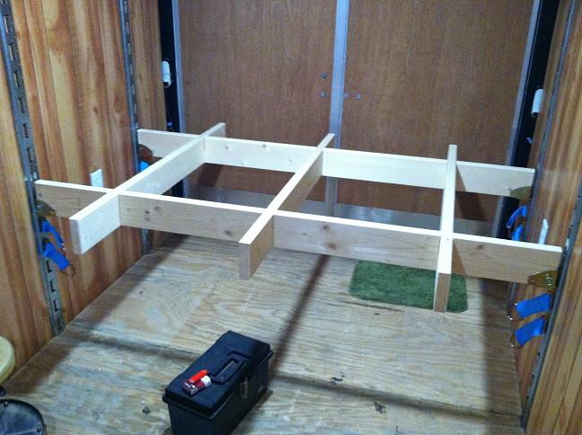

Got some work done on the bed today. Got an 8inch thick memory foam mattress from amazon. Wanted to be able to easily move bed and break it down depending on what I wanted to haul. Used vertical E-track so I can adjust the height as needed. Used ball lock push pins to secure to E-track. Everything else is simple wood joinery.

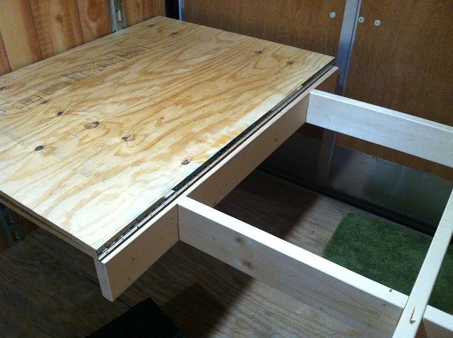

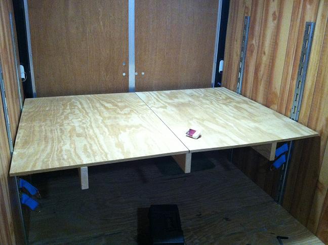

3/4 base for the mattress. Used a piano hinge so i could fold up the plywood and make it easier to handle when i need to move it. Tomorrow i will mill some of my rough sawn oak down and make some nice smooth edging boards for the sides of the bed. It will look nice and eliminate any splinters.

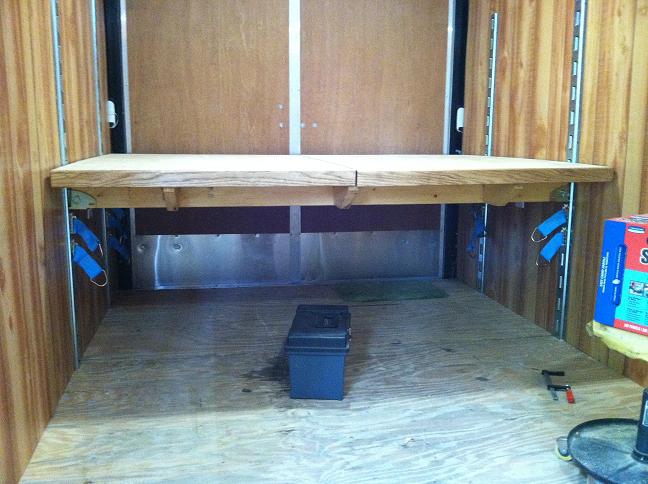

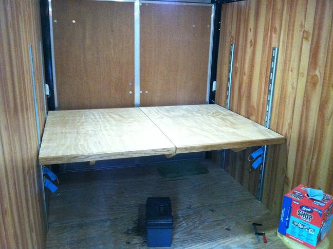

Here's the finished product with the bed. Everything is functional and stained. All i need now are some bed sheets. I'm gonna get one of those pass through for the coax. Since i cant make up my mind on where i want to mount it, i think i will just make a magnetic bracket i can attach to the side when i set up camp. who knows, maybe it will just stay that way. Going to start on the kitchen countertop today.
