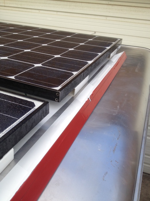

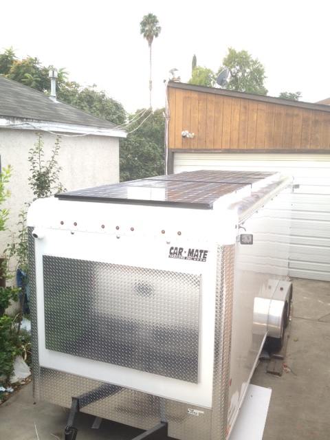

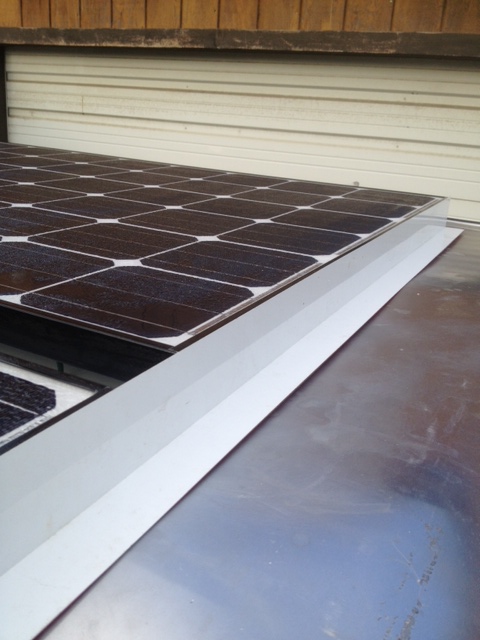

Postby OverTheTopCargoTrailer » Sat Aug 17, 2013 1:24 pm
p 2-4.JPG (122.05 KiB) Viewed 905 times
I just used a long metal strip with VHB tape & will put screws in to hold panels secure
