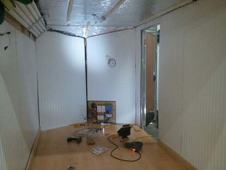

Wasn't going to do walls just yet but new floors made walls look pretty bad. Primed bead board paneling will probably be painted white

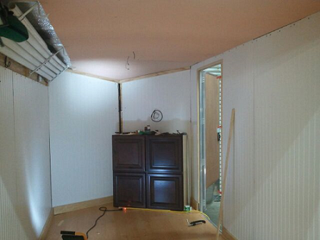

Not the best of days as I had to remove some paneling to reset the plywood underneath so my trim would fit. Air compressor took a dump so I went old school with paneling nails and hammer. That sucked... a lot. Not a fan of the V Nose that slants down as far as ceiling and trim work. Wouldn't buy that feature in the future. Did get paneling fixed, ceiling installed and part of trim work done.

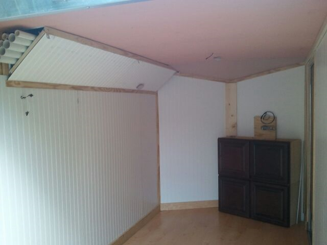

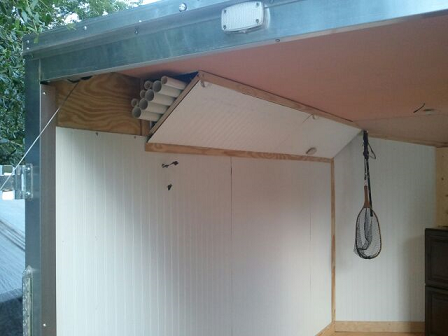

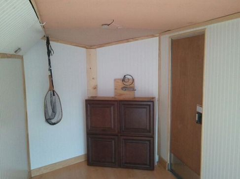

Majority of trim work is finished. TV mount and a few pieces to complete rod racks should do it. I have another cabinet I may add later. Im undecided on countertop as of yet but I plan to have it span cabinets but only come out 14-15" so as to not be in the way of entry door. II am planning a folding fly tying desk and hanging shelves from Cabelas. Am undecided on bed but considering futon with memory foam added or just standard mattress. Should be wrapped up and on the road after this week.
rod racks boxed in

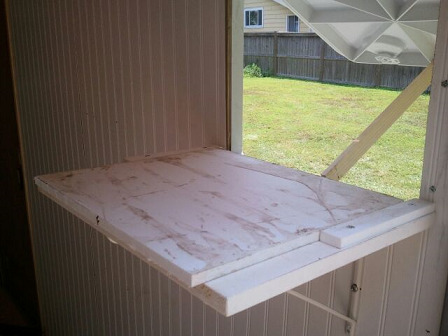

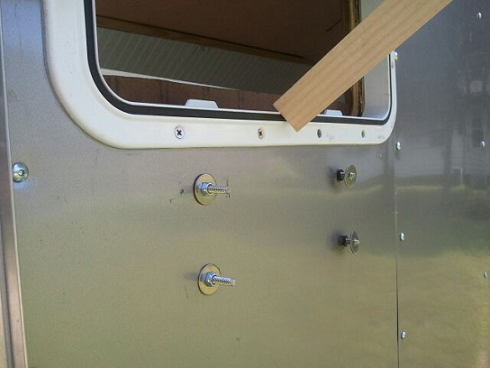

Didn't like previous set up for AC. I was going to have it as a fixed mount and though it was only going to stick out about 7-8 inches I decided I wanted it inside a hatch. I built the shelf with brackets and a piece of 3/4" starboard and then added a slider on top (1/2" starboard) that the AC will be attached to. The AC and 1/2" sb will slide in and out of hatch. I put the screws through from the inside so as to leave threaded studs on outside. These will be attachment points for another small shelf to help support weight of AC. It will be removable and will only be added when the CT is set up to camp. When I leave it will be removed (wing nuts) and stored.

Exterior studs
