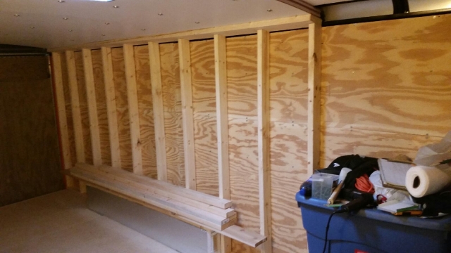

Postby Chilly Willy » Sun Oct 26, 2014 2:20 pm
Wall one up.
Might seem strange to add all that lumber when its not even a structural wall. However it'll be holdind 3'' of insulation, pushes up nicely on my ceiling panel edges, and will give lots of mounting options for items later.
