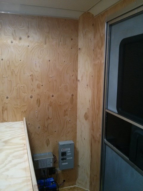

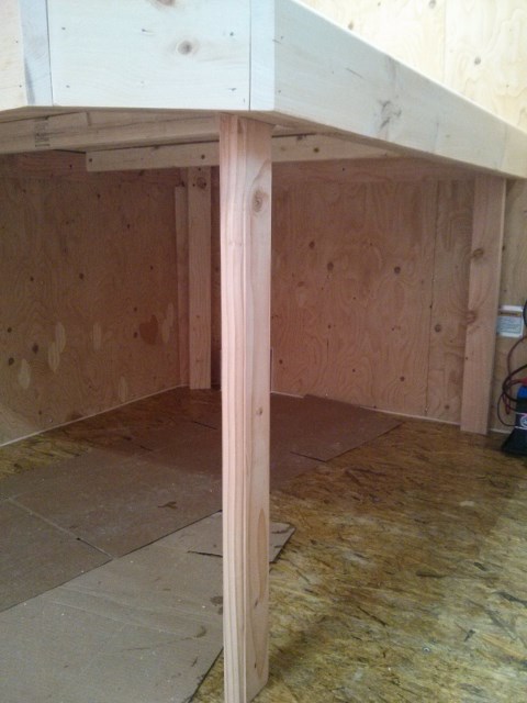

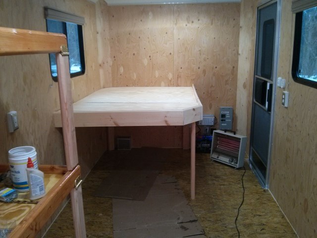

Also, built and installed the main bed platform.
Main bed.jpg (102.89 KiB) Viewed 3256 times
Main bed 2.jpg (90.8 KiB) Viewed 3256 times
Main bed 3.jpg (95.01 KiB) Viewed 3256 times

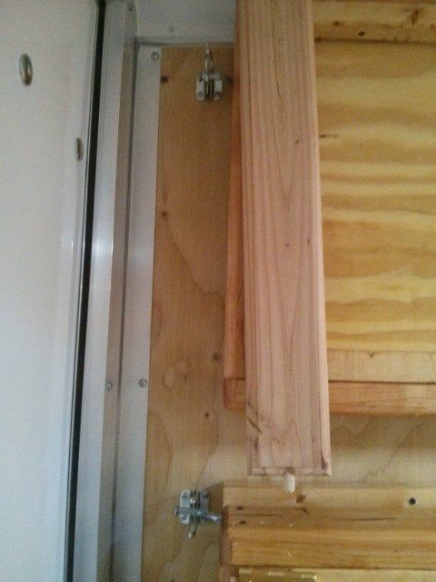

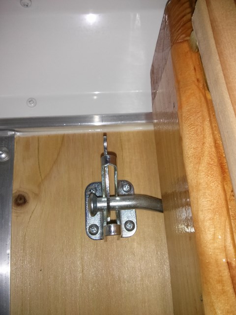

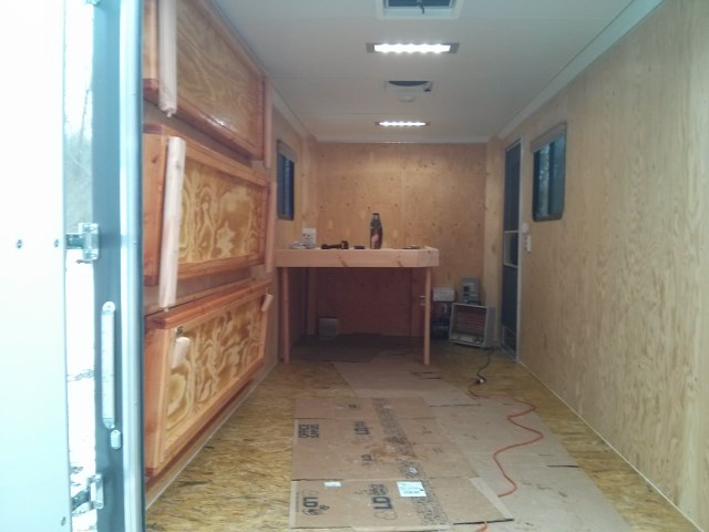

Gate latches seem to work well for now holding the drop bunks to the wall. Will they hold in bumpy transit? I will lock with a carabiner but not sure how much force they are being subject to.
Bed Latch.jpg (89.75 KiB) Viewed 3241 times
Bed Latch 2.jpg (101.42 KiB) Viewed 3241 times

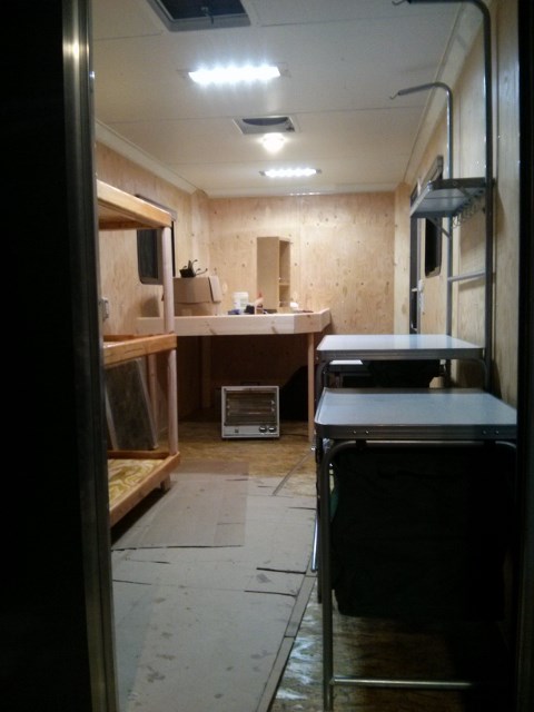

Re-used our big Cabela's Camp Kitchen: http://www.cabelas.com/product/Cabelas-Deluxe-Campers-Kitchen/715223.uts
Cabelas camp kitchen.jpg (87.63 KiB) Viewed 3241 times
Gonefishin''s setup has been my inspiration: Simple, light, happy and care free. The trailer must retain its original cargo capacity for 5 kayaks, 5 mountain bikes, and 2 not very small German Shepherds.
I also will be installing the hot water heater: http://www.eccotemp.com/eccotemp-l5-tankless-water-heater-w-flojet-pump-strainer/
And, again, a nod to Gonefishin', the Dickinson Marine Propane heater.

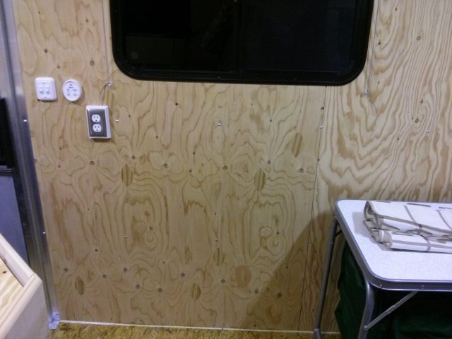

Postby outsidezion » Sat Dec 13, 2014 5:57 pm

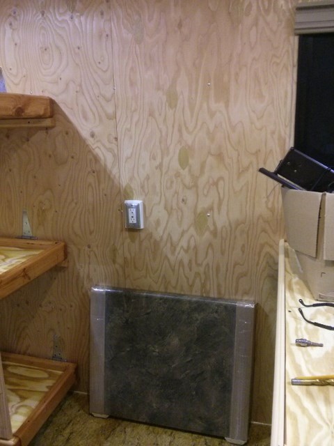

Which leads me to next weekend's project: where do I install my Dickinson Marine heater?
Center, roadside, close to the floor:
Center, road side.jpg (99.46 KiB) Viewed 3239 times
Front or Front curbside:
Front, Curbside.jpg (88.64 KiB) Viewed 3239 times
Or Center, curbside, below the window (and what problems would that cause?):
Center, below window curbside.jpg (100.82 KiB) Viewed 3239 times

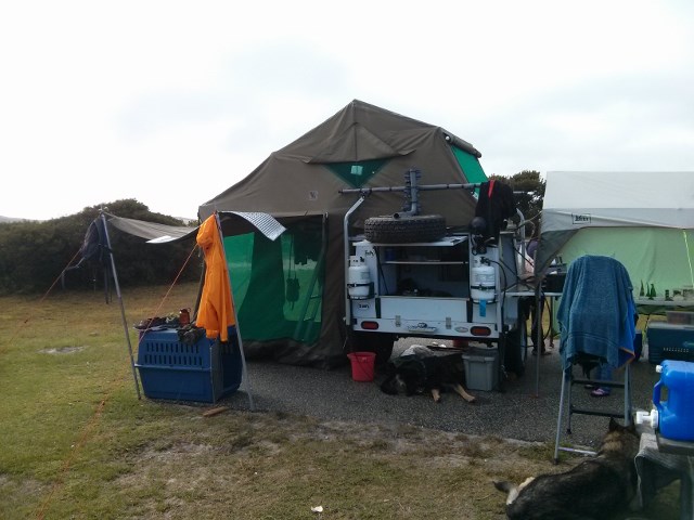

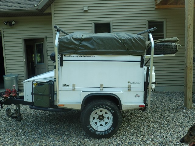

I'm coming from a backpacking background and also an overland style of camping so the basic amenities in a fully enclosed cargo trailer feels luxurious.
My last trailer was an overlander from South Africa:
P7300006 (640x480) (640x480).jpg (131.25 KiB) Viewed 3201 times
Rear 2 (640x480).jpg (106.79 KiB) Viewed 3201 times

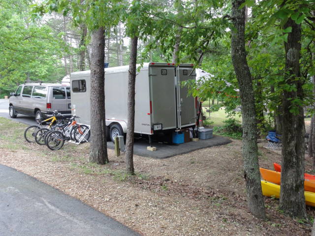

Nice build, really like those ATC trailers, Gonefishin a hero of mine as well. Kayaks, kids, mountain bikes, very familiar. 7x16 was the ideal for us as well.
You may have viewed our build already, but if not:
http://www.tnttt.com/viewtopic.php?f=42&t=48345
We used the removable bunks to hold kayaks as well as the super handy vertical e-track (ugly but really functional and modular):
I think Gadgetman built a neat removable PVC pipe kayak rack as well, somewhere around here...
PVC bike rack is really handy inside and outside the trailer:
