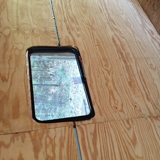

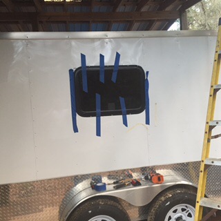

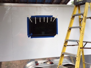

Postby MyYota85 » Fri Mar 13, 2015 9:25 pm

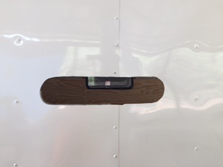

Got the hole cut, measured about ten times and cut once, just had to trim a hair on one of the corners. Tin snips did the job for that. Bought some SS screws and put three up top and three on bottom.
First pic is just sitting in and the second is all screwed minus the silicone

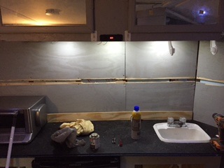

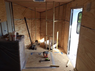

Postby MyYota85 » Sat Mar 14, 2015 6:48 pm

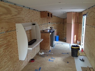

The inside view of the window, it didn't come with trim so I'll have trim with wood. And the shower is almost framed up.

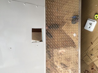

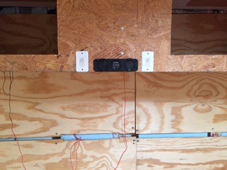

Postby MyYota85 » Tue Mar 24, 2015 9:06 pm

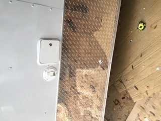

Got the water inlet and electric inlet installed today.

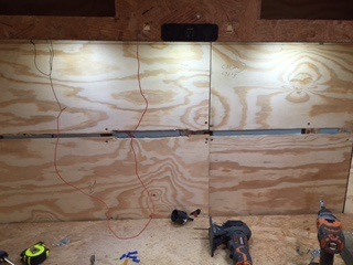

Postby MyYota85 » Fri Mar 27, 2015 1:21 pm
I've got one more window to install if YA get bored prem!
A lot of things have been getting done including ceiling is painted countertop is on upper and lower cabinets installed almost all water related piping is done and all lighting is almost done.

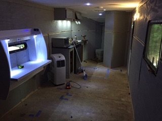

Postby MyYota85 » Sat Apr 18, 2015 10:00 pm
Here's a quick shot at the almost finished product.

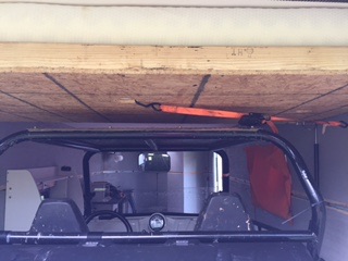

Postby MyYota85 » Sun May 17, 2015 11:58 am

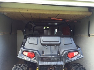

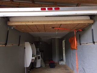

Well I'm basically finished with my conversion minus the painted trim work. I've been sleeping on a huge blow up mattress UNTIL this weekend. Man this 6"gell cooled mattress is comfy. I mounted it on four of these struts from the back of a pathfinder door. And then four gate latches (2 was to shaky). So up and outa the way my rzr has prop 3" of clearance.

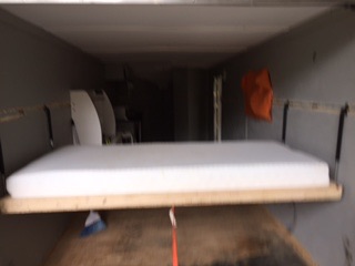

And here it is down in sleeping mode.

Postby Gunman9 » Sun May 17, 2015 1:34 pm
MyYota85 wrote:And here it is down in sleeping mode.
Where did you get the shocks to build the bed and how was it set up?
Gunman9
Posts: 118
Joined: Wed Apr 22, 2015 4:32 pm
Re: 7x18 vnose Diamond cargo with pics
Postby MyYota85 » Mon May 18, 2015 7:23 pm
My wife drives a Nissan pathfinder and i had to replace the 2 struts on her back door. So i did some measuring and found that 4 of these would work perfect! to get the bed up or down i just slide it in toward the inside of the trailer as the bed pivots up/down. the up part is a bit to awkward.
