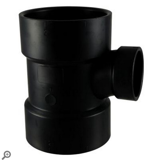

That's a good suggestion. I just noticed it after I posted the pic of the sani T I was looking at. I've thought about that style. It might be trickier to plumb but it would definitely be more effective keeping the drains separate. I like that.

I like that solution Hank. I've thought about that style. I thought it would be trickier to plumb. The underside of my trailer is going to be a challenge to plumb. There is a lot of metal framing in the way and I'm trying to keep everything up as high as possible for clearance.

With that Wye you would need a 2" 45 degree street hub. I probably didn't explain it well. The 45 degree street hub connected to the Wye's 2" hub makes the 2" perpendicular or level or 90 degrees to the 3" pipe. I emailed Valterra for a dimension on that fitting. They answered right back by the way. The wye hub is close to 7 inches long. Way too long for what I need. I bought a pvc toilet flange at Home Depot today and I bought a 3" sanitary tee with the inch and a half hub on the side. It was only 5.5" tall. Thought it would work but got it home and realized while underneath the trailer, it wouldn't. I ordered the Hepvo trap too from Amazon. I've got another idea for the toilet drain. It will involve two elbows. The second elbow is not stocked locally. Had to be ordered. It's one of these:
http://www.homedepot.com/p/NIBCO-3-in-x ... /100678004
I'm trying to keep as much clearance as possible underneath. Plan for now is 3" elbow connected to the toilet flange and then connect the 3x3x1.5" elbow horizontally so the 1.5" is facing up and then connect the 1.5" sink drain pipe to it from above. When I get this plumbing project completed, I'm going do a detailed description of it in a separate posting with details, links and pictures. That way anybody considering it for their trailer might benefit from it.

I saw a picture of your combination elbow...it would be better to drop your sink line in from above, as in a tee.
All secondary gray water should enter the main drain above the toilet drop, but if it can't, a sanitary tee will work as long as the sink bowl/pipe connection is above the top of the toilet bowl, so that if the system backed up the sewage would not come out into the sink.

I understand your thoughts of using the 90 with an end outlet, but you can do better with regard to height by placing a 3 x 3 x 1.5 tee in a horizontal run and dropping the sink line in from above.
You are starting with the toilet, dropping straight down into a 90, then running horizontally to your outlet point.
The sink line can be run above the floor to the area you can best locate the tee, where it can drop down. In this way you can avoid all the steel framing.
Another consideration is placing a 90 so close to the toilet outlet. The 90 is generally 12" or more below the toilet. It may or may not be an issue if closer.
For the sink connection, not above the flange, but above the top of the toilet bowl, as if the toilet backed up, it would spill out once it reached the top of the bowl.
