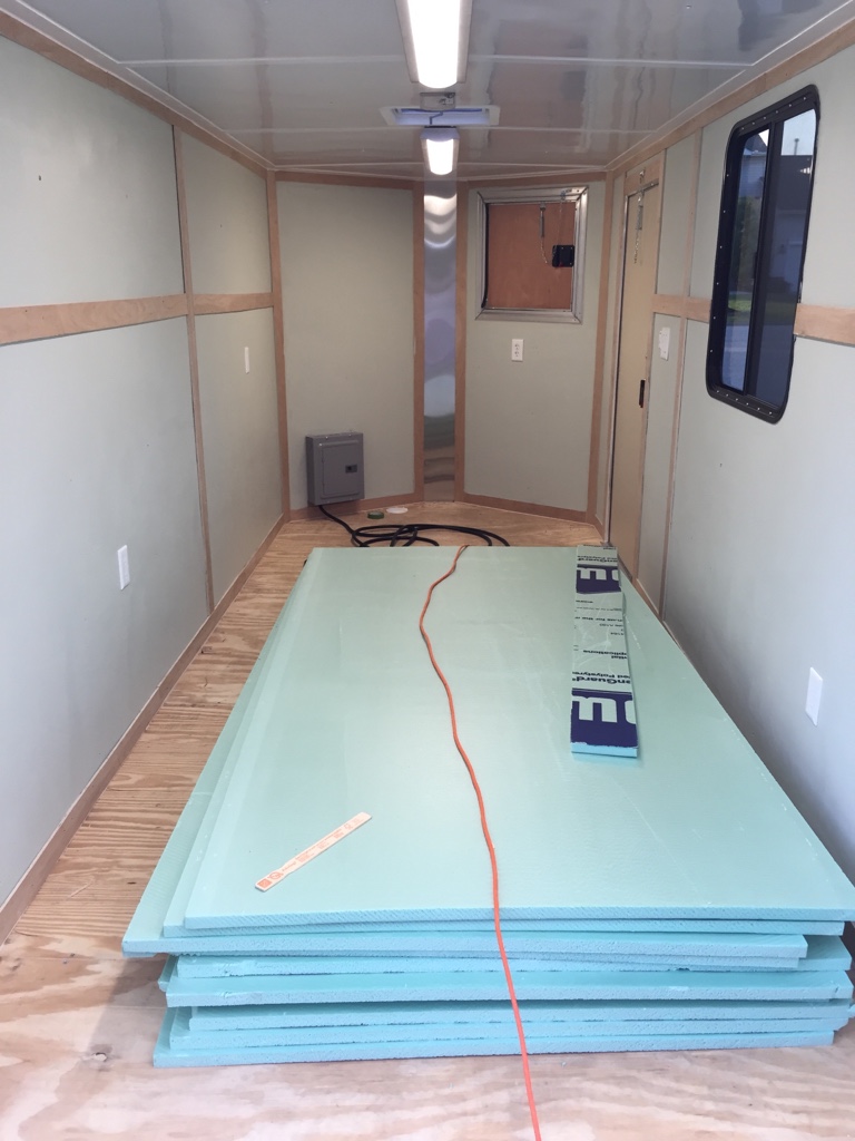

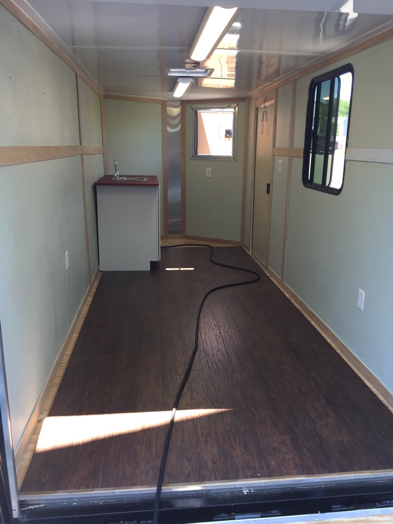

Update #1:
Insulated the walls and ceiling and obviously over bought on the foam so back to lowes tomorrow to get some money back and buy a mini fridge. I got the floors to put in tomorrow as well. I painted today and need to paint the trim tomorrow before the floors go down. Will install the window ac at some point to it's supposed to be cool out the rest of the week.

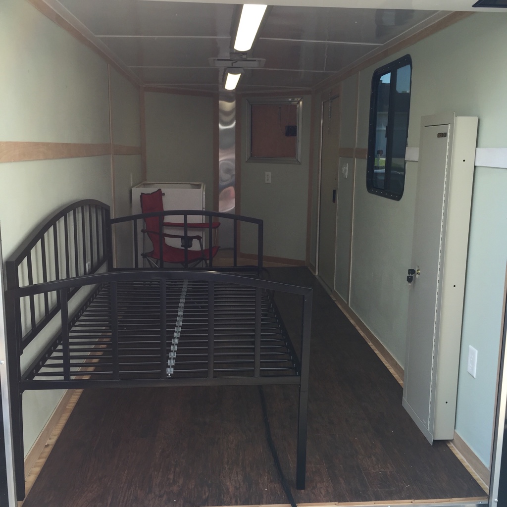

Postby Gunman9 » Fri May 22, 2015 11:40 am

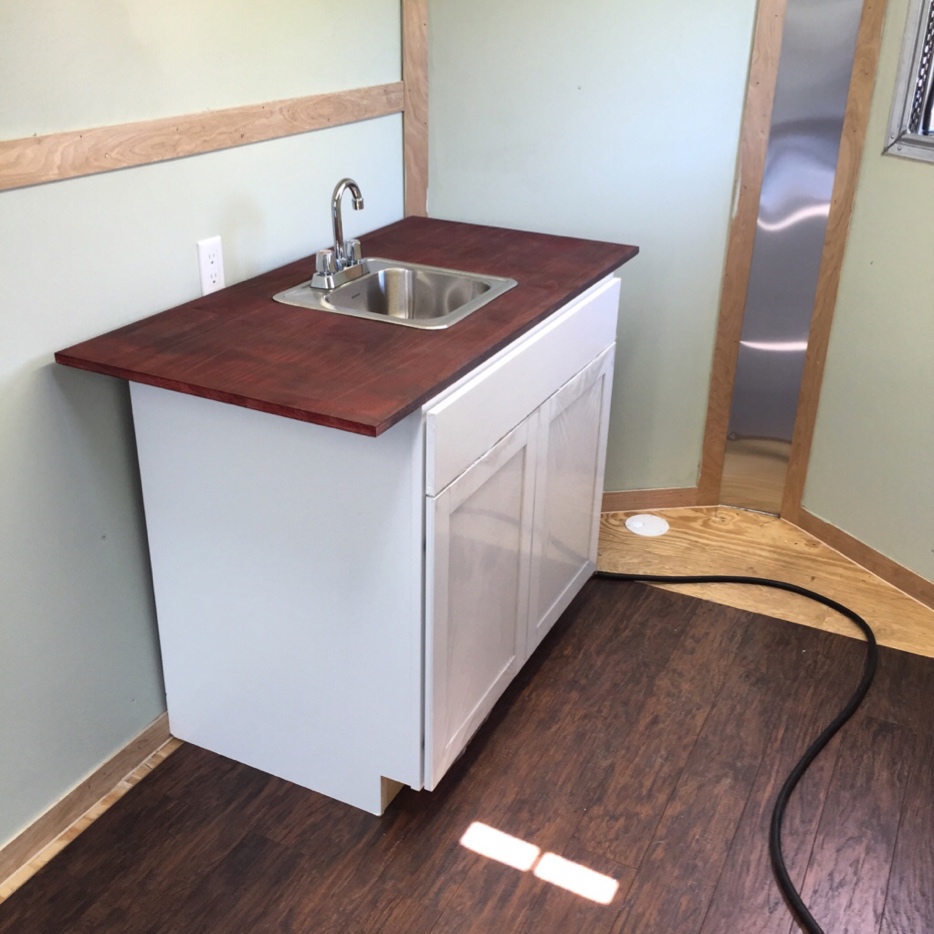

Update #2:
Laid the floors and got this 36" cabinet at lowes for $50 originally $225! Made a counter top for it and the work continues.

Postby Gunman9 » Fri May 22, 2015 8:44 pm
I wanted to leave a gap for it to expand an contract. The gap is only 3/4 of an inch I am going to just trim it out where there isn't anything covering. Less work and kills two birds with one stone. Here in VA the humidity is crazy in the summer and I worry about the flooring warping and didn't want them buckling against the walls. 3/4 is overkill but better safe than sorry and when it's done you won't ever see it.

Spotman wrote:Is that a recycled Military iron board cabinet? I remember those.
What lol no it's a stack on in the wall gun safe from Walmart lol

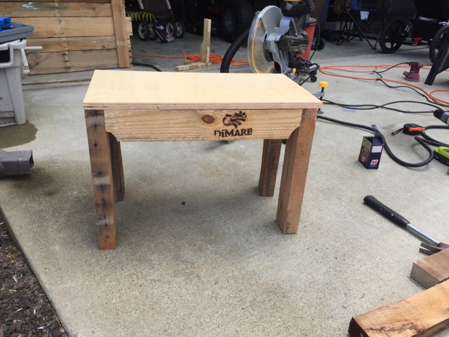

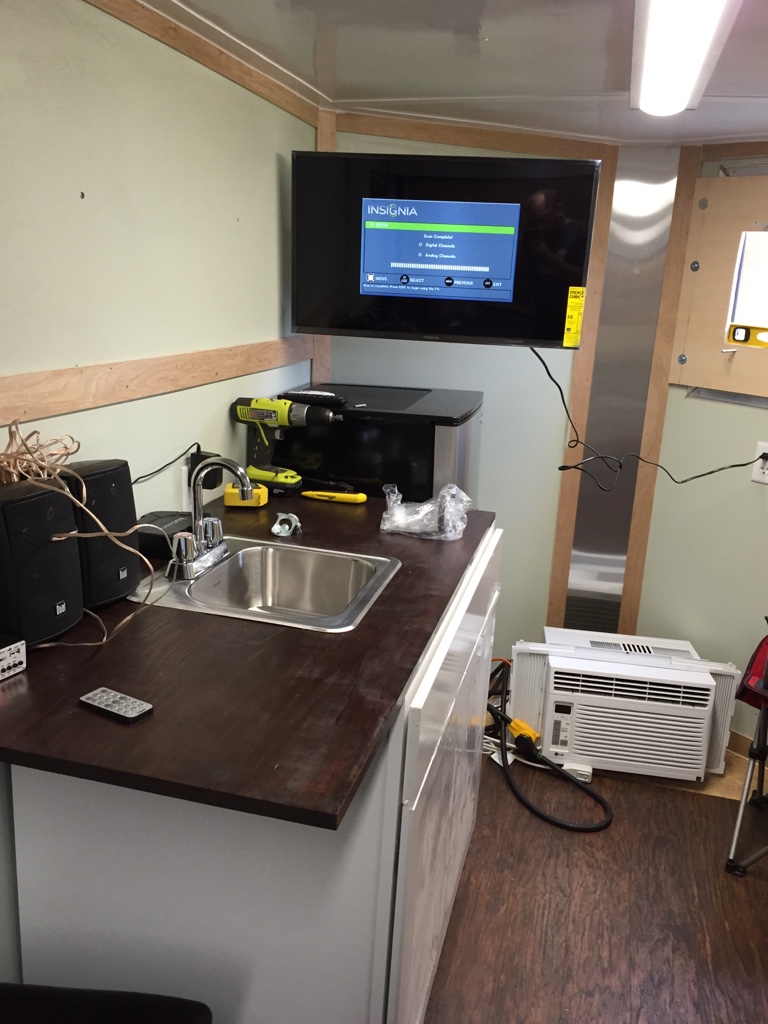

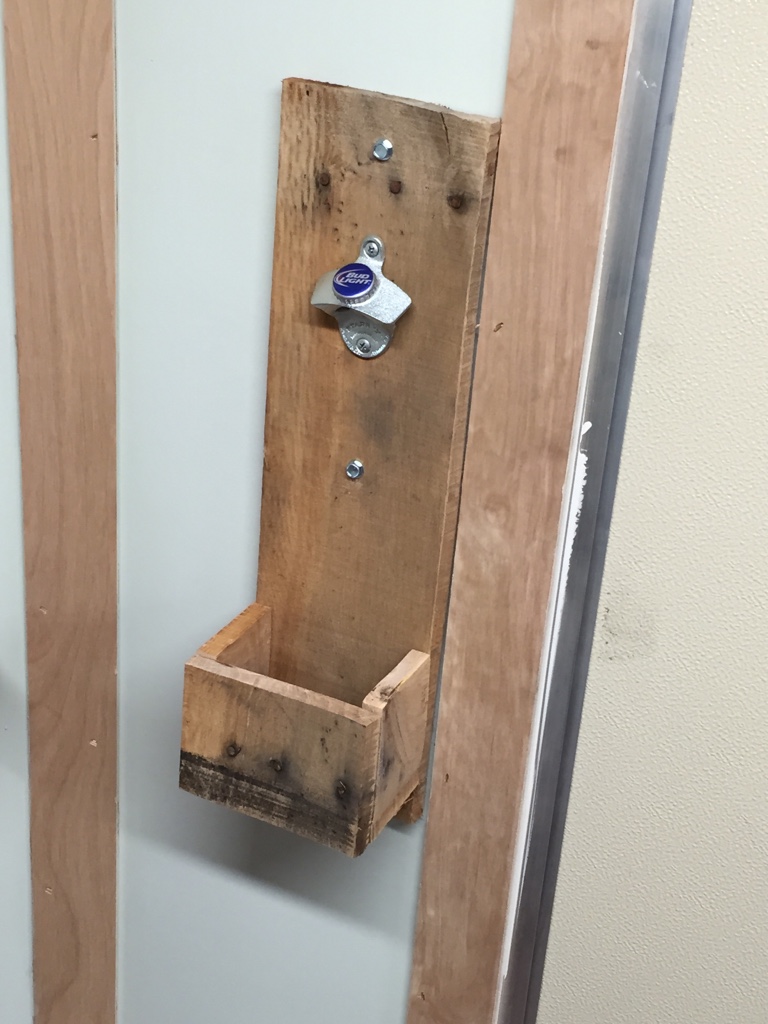

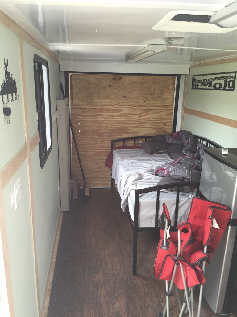

Postby Gunman9 » Wed Jun 03, 2015 12:27 pm
Re-arranged the inside to better suit my needs. Hung the TV, built a pallet bench and a pallet bottle top catcher. It's coming along but there's still a lot to do.
